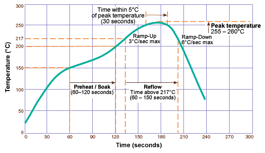

I don't think it's questionable at all.  Obviously these IC's had to survive a reflow profile (see below) which peaks at 260 *C and that's after enduring a 60 soak at almost 200 *C.  Consumer grade hot glue melts at ~127 *C and industrial high-temp glue melts at ~194 *C; both well below the reflow temp of the solder.  You are, of course, free to glue it to where ever your heart desires.

your comparing a reflow of the whole board, to applying direct heat to only a small portion of the IC. not the same.  While all of this may work fine without any issues, gluing to the IC's is bad
If you don't think every single component on that board is going to reach at least 127 *C after soaking in an oven for 3 minutes at temperatures greater than 150 *C then we will have to agree to disagree because there isn't much more to say.  It really is a non-issue; geekonaut offers up the same findings.
