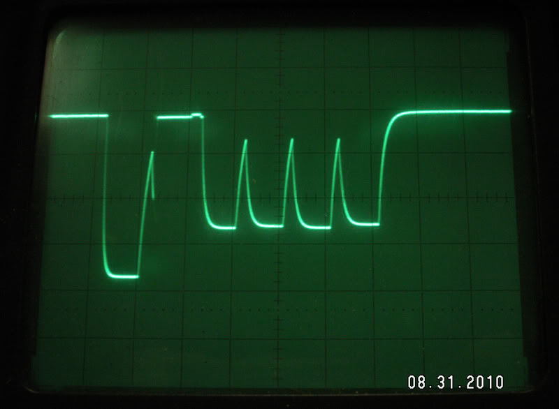

That will look like this on you O-scope once it's done right.

Change your scope coupling to DC and measure COM3 again, cause it sits Lo and pulses Hi for 500us, and it does it at the same time the COM2 lines starts to do its thing, so it's perfe3ctly usable as a trigger versus watching for COM2 to fall.
COM3 Top Trace
COM2 Bottom Trace
« Last Edit: March 16, 2018, 04:42:58 PM by RDC »

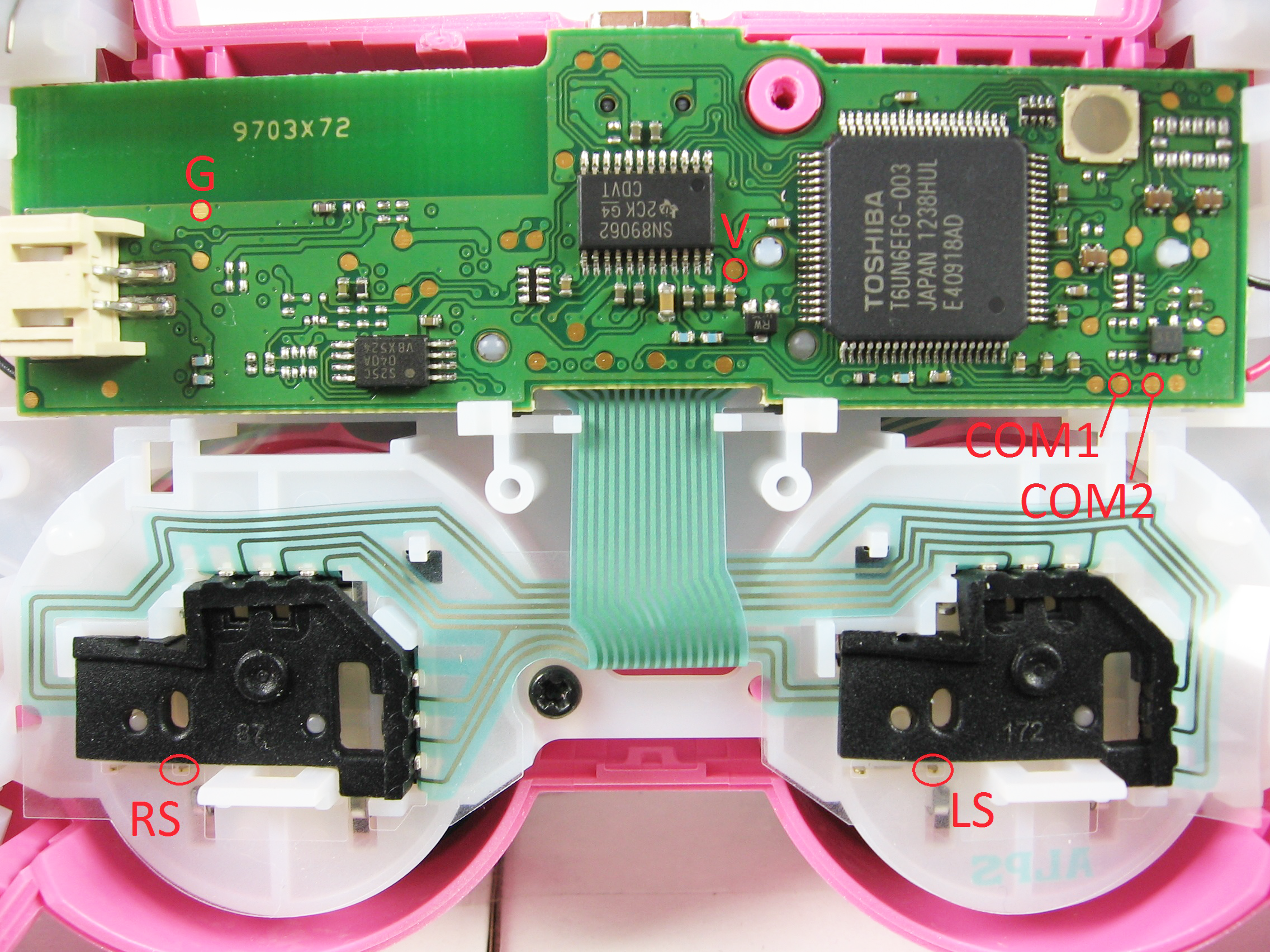

just com2
com2 & r3 in blue
Controller board.
Vx7 and believe me I have another brand new controller with a even newer board.
And this is not a actual pic of mine but rather one from vikingmods
« Last Edit: January 19, 2014, 06:03:41 PM by grizzfu88 »

I found COM3. On the top of the PCB is a section of 20 contacts(two rows of ten) designed to connect the flex pcb to the actual pcb. With the PCB oriented like you were holding it to play a game the pad for COM3 is on the top row 6th from the right.
