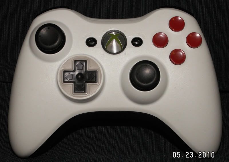

The last one I did, 4 years ago now, I went from more of a Nintendoie controller look and did all 4 ABXY, then swapped the Sticks, tail piece and other buttons for black ones. The NES buttons in it haven't been touched on the top half of them, just opened up the shell instead, so they still look/feel the same.
