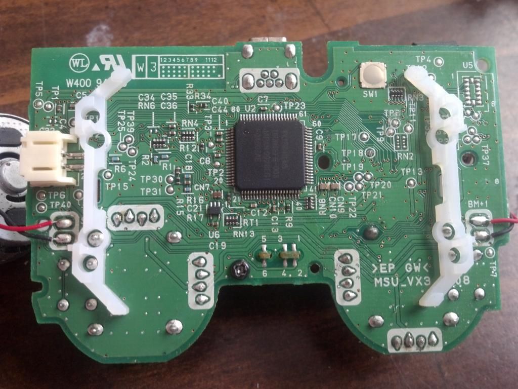

Hi guys, my older brother attempted to mod a ps3 controller with rapid fire last year. and the the controller stopped working. When the usb cable is plugged in the status led lights and blinks as if it is charging. But the problem is that none of the button are working. I had it at full charge and still nothing happens when the buttons are pressed.
Here are some pictures:

Static electricity damage most likely. Probably a dead controller.

Make sure that small foam piece is in the Daughter board brace. It sits behind the contacts of the Daughterboard and presses it against the motherboard contacts when everything is together. If it's not there, then the connection between the Daughterboard and motherboard isn't made good enough and no buttons will work.

My brother brought it to me this way and yes i made sure the foam piece is making contact. In fact, i even added a bit more foam to make sure it is making contact. Still none of the buttons are working. I am ordering a new flex piece to see if that is the problem, i don't want to spend any more time or money on this controller. Since there are different variation in the ps3 controller, is it safe to assume the flex cable piece is also different? Meaning certain flex only for certain boards? Thanks for your input guys!
Edit: FIXED!!!!!! so i called my brother and ask him what else he did to the controller and he said that he swaps the rubber conductive pads for the start button cause i "accidentally" burned it with the soldering iron. So i took a look at the replacement he bought and yup its the wrong one. I had a spare from his sons' destroyed ps3 controller and the pads line up and the controllers syncs and works no problems!!!!!!!!

The Daughter boards have slight variations, but will work for the most part on the different controllers. About the only thing that would make a Daughterboard fail is really, really filthy/corroded contacts or damaging the pull up resistors on it, or bending it so much it creased and severed a trace. If the thing has been apart for a year the contacts on the DB might be corroded up too much. You can take some really fine grit sandpaper (2000 or so) and lightly go over them a couple times at most, then clean with rubbing alcohol, but I've yet to see that ever make a difference even on older DBs than that.
