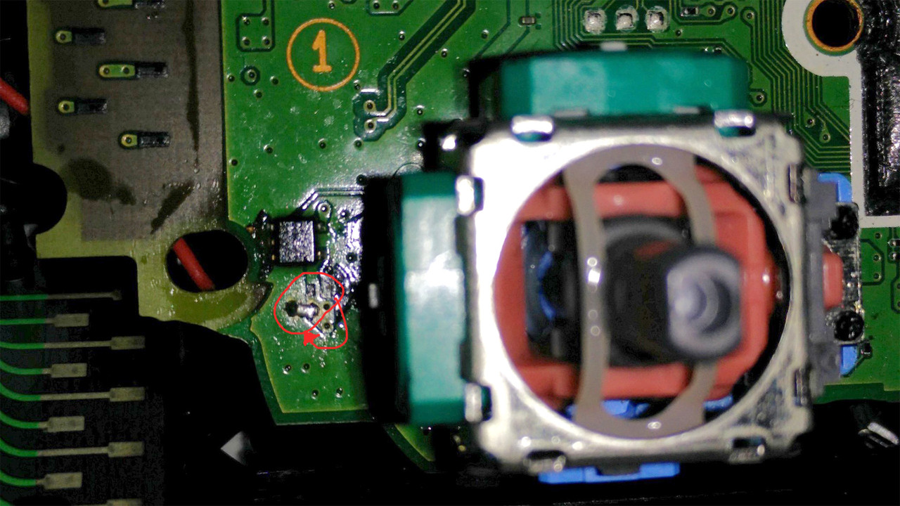

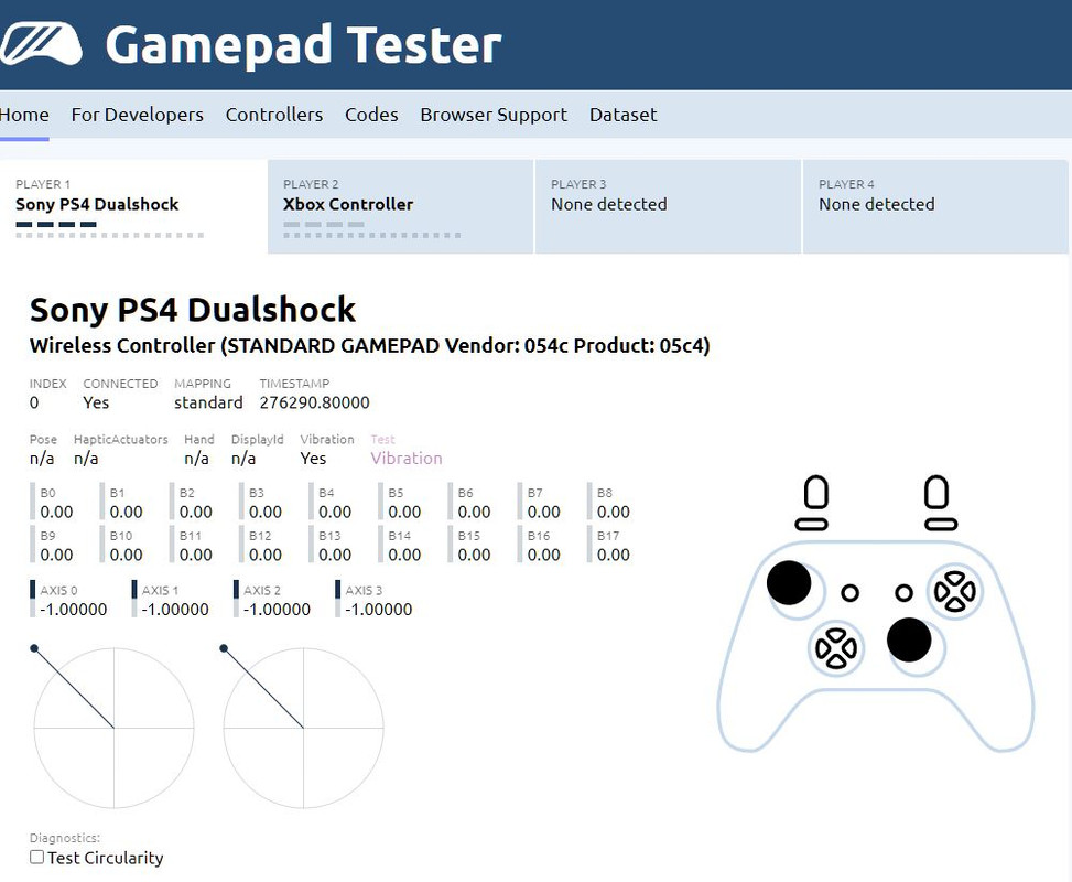

Hello again guysAfter desperately trying to replace my dualshock 4 right analog stick with no proper tools (didn't have a hot air station so i worked with only a soldering iron) i did some damage to the analog stick pinholes and the soldering pads on the board but still managed to replace it and do the soldering.
Everything works fine except the R3 button which acts on its own when i spin the analog, and it's always staying put when i leave it untouched, you can see the R3 button inputs here:
https://files.fm/f/39vyfe9dy
I'm sure the analog stick itself is healthy so anyone having any idea how to resolve this? i don't have the right tools for this and kinda don't want to remove the stick again and causing more damage
I'm assuming some kind of short circuit might causing the problem but i don't know exactly where
Any help would be appreciated
Thanks in advance
« Last Edit: November 03, 2022, 04:07:32 PM by Semtex »

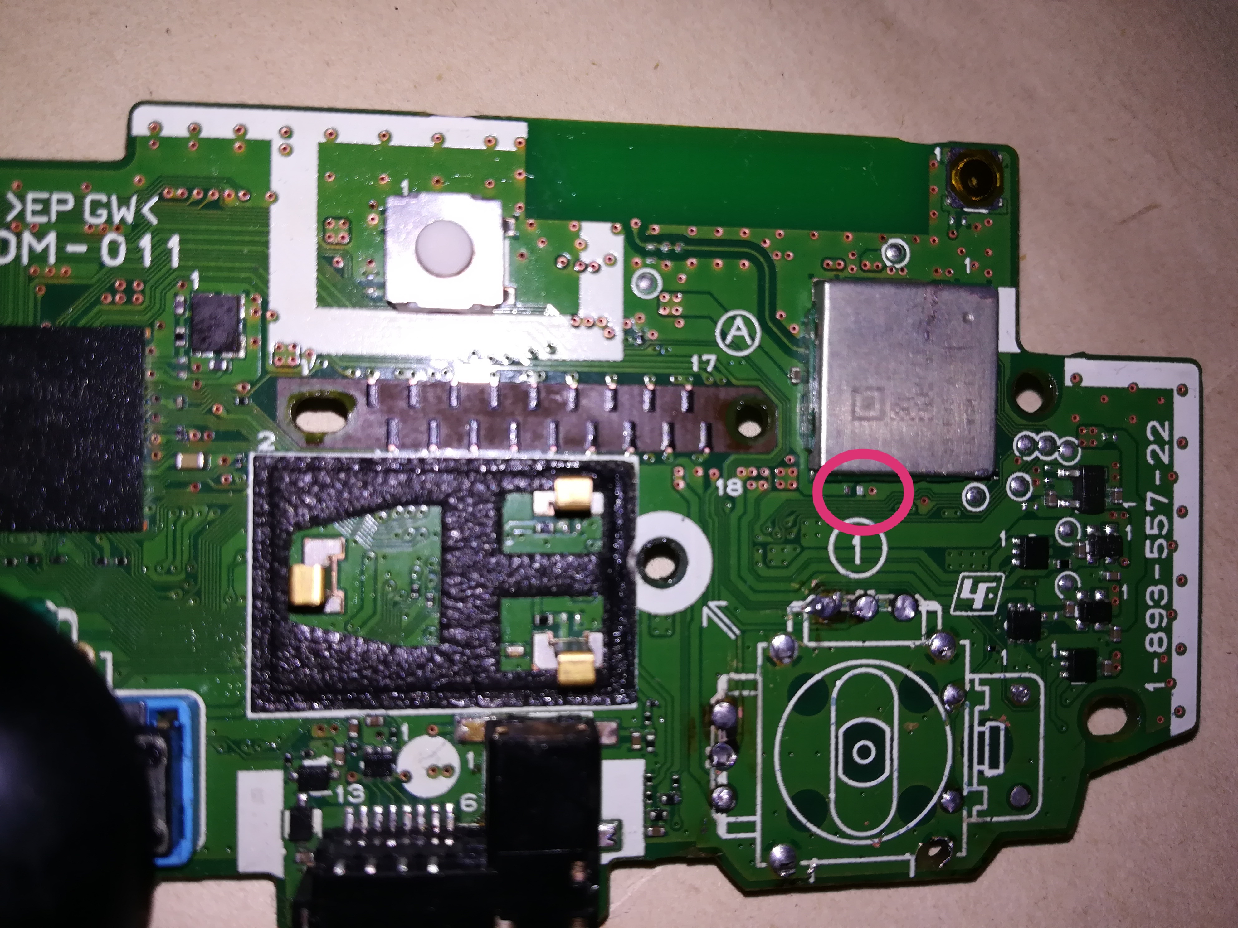

Which version of board do you have? or get pics of your board around where you were working on it. I'd guess you probably knocked the 100k Pull-Down Resistor for R3 off there, as that will make R3 act all goofy, but I need to know what version board it is.
Offline Semtex
  • Posts: 15
Re: DualShock 4 Controller PCB scans
« Reply #354 on: November 03, 2022, 05:25:27 PM »
It's jdm 011 version
I took this pic before analog stick installation hopefully it helps
  • Posts: 2642
« Reply #355 on: November 03, 2022, 05:39:19 PM »
Make sure this little guy is still on there first.
Offline Semtex
  • Posts: 15
« Reply #356 on: November 03, 2022, 05:54:49 PM »
I checked it out and it's still there with no damage taken
This is the only obvious component which i broke during the soldering, could this be the problem?
« Last Edit: November 03, 2022, 05:59:41 PM by Semtex »
  • Posts: 2642
« Reply #357 on: November 03, 2022, 06:13:21 PM »
Nope.
Does the R3 work normally? Press the stick in and it registers?
« Last Edit: November 03, 2022, 06:18:39 PM by RDC »
Offline Semtex
  • Posts: 15
« Reply #358 on: November 03, 2022, 06:28:58 PM »
Nope.
It usually does when it backs to a normal state like after playing with it for a while, but most of the time when i turn the controller on or plug it in R3 button acts on its own at the start (like being pressed all the time) just like the video i sent, so strange!
« Last Edit: November 03, 2022, 06:46:33 PM by Semtex »
  • Posts: 2642
« Reply #359 on: November 03, 2022, 06:50:47 PM »
Measure the Resistance of the R3 button line there to ground.
