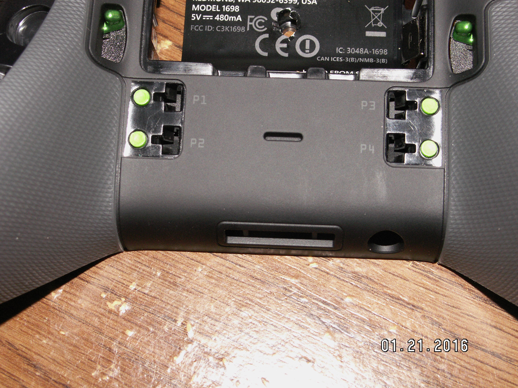

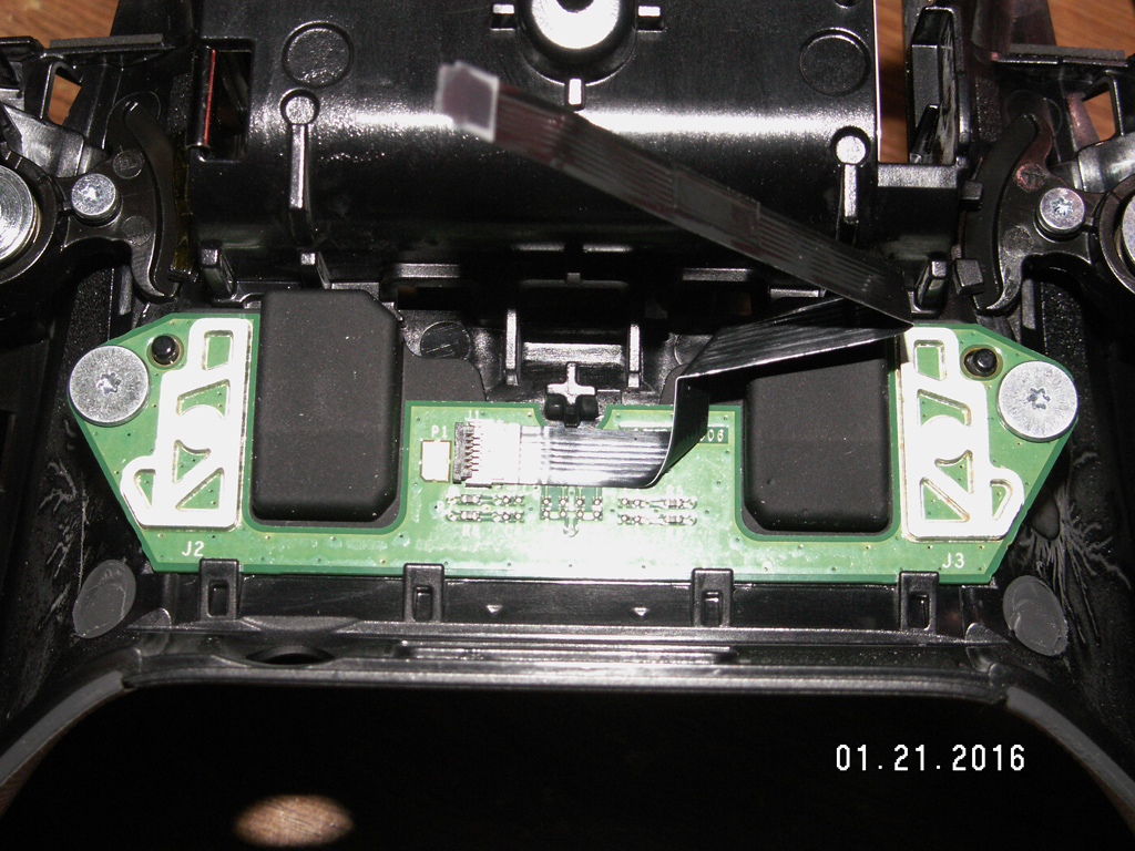

The Paddles appear to be Common Ground. They are using a 6 connection Flex cable to connect the Paddle board to the main board, so 4 are the buttons, 1 is ground and the last one I haven't determined yet and most likely will not on this controller. There is also a ground connection made from the MCU board to the Paddle board with a compression connector.

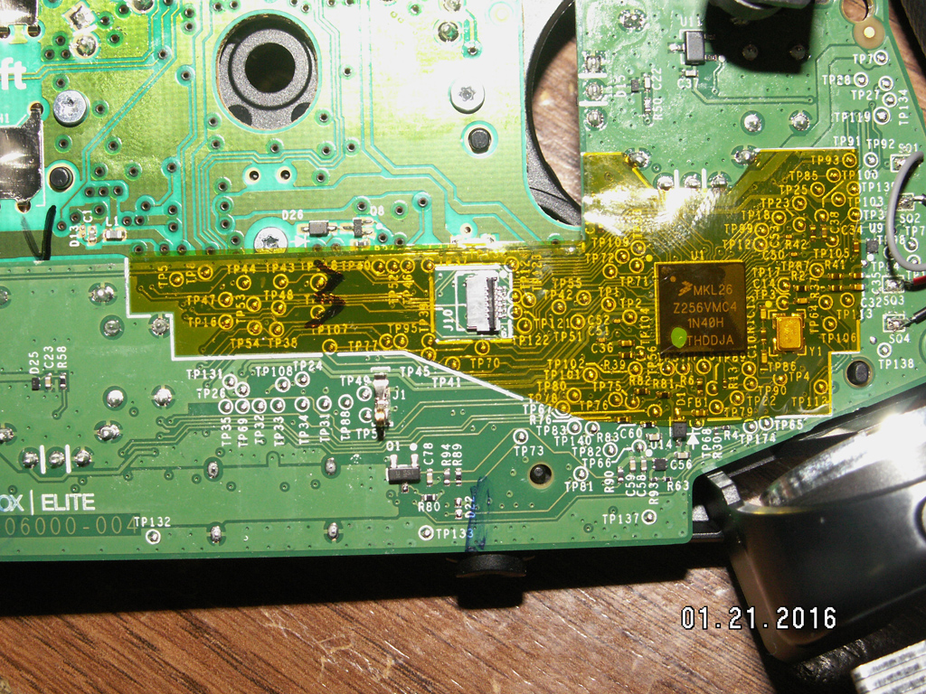

On the Power board, they are using the IR LED connection for the 1/2 switch line. This one also has no IR LEDs and seems to be mostly a 1697 with some changes for the Paddle board and the other shell changes. Sadly it's really just a matter of the slight mechanical difference for limiting the Triggers and some code for the rest of it that differentiates between the stock $60 controller an this $150 (ripoff) one.
Not a lot more I can do with this one as it has to go back to it's owner, and I don't want to go tearing into it like I normally would, but they did some changes in here on both boards. I'll get one later on so I can do a proper tear down and thread for it (maybe when that hot place get s a bit cooler, or if someone that cares not for money sends me one) but until then here are a few pics. If you need to see something else let me know while I have it here the next few days and I'll see what I can do.

Do you think the original MOBO will lay in the shell over the paddle assembly?
I can probably port the chip I am using over, but I am worried any software changes may affect the way the Viking chip operates.
What is up with the Mic port? Is that a 3.5mm jack? The shell appears to have the slot for the xbox mic port also??

If you try to put the 1537 into this thing, the MCU will hit the Paddle board, and you'd have a gaping hole where the 3.5mm would be.
If you try to put a 1697 into this thing, which also has the 3.5mm port, the shielding of the RF board will hit the Paddle board.
Just from the looks, I can't imagine they changed the core of how it works, but I'd need one that I could tear more into to know for certain. The buttons are all still in a CG layout, and the Triggers are still Halls. I'd have to scope them to see if they changed anything there, but for all intensive purposes it's the same as a 1697. What I mainly meant by this one having different code is for the 4 Paddles and then the 1/2 selection switch. The 1697 is capable of being this 1698, but I doubt it has the connections broken out even if you could update the MCU on it.
