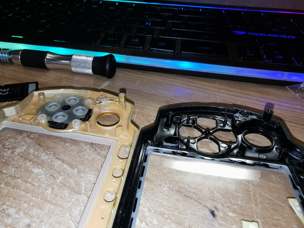

I stripped down my 2000 and compared the shells, and in the rear half there are a few posts that hold the metal shield that are in different positions between the two. In the bottom left corner the screw post moved from above the headphone jack to near the strap loop. I removed the nubs, and shortened the post so the headphone board from the 2000 would fit. I used some double-sided tape to hold the shield in place.

Since the one screw position changed, the D-pad button/left screen bracket no longer have a provision for the bottom screw. I was able to assemble the PSP without it and everything seems fine.. A guy could 3D print a part to provide the screw hole if need be but I don't think its necessary.
Looking at the front faceplate, they're very similar. I had to remove the two nubs that are in the middle of the home row buttons, but that's all that had to be modified on my 3000 face.
Here they are side by side:
The 3000 faceplate is thinner at the ends compared to the 2000 faceplate:
I had to trim down the lip on the edge of the D-pad bracket some to provide the clearance needed for the faceplate to fit.
