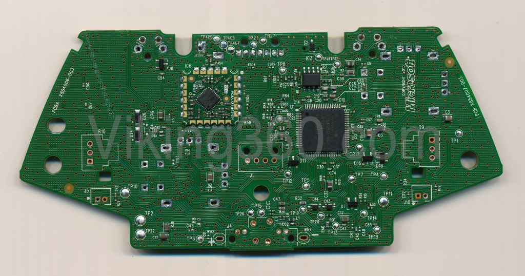

i have a controller xbox 360 wireless with a problem... not connect, i try with xbox 360, with pc receveir but nothing. I tried with another controller and it works, where do I have to check to be able to fix it? some tell me it may be the wireless card and in case i have another broken controller where i could recover pieces.

No idea what controller you are referring to, because there are 5 different versions of the Wireless 360 controller board.
Try to connect it to the 360 with a PnC cable first, see if it will pair to the console.

The board is  this
Pnc cable not work.
I have another broken card the same, could I unsolder the chips concerning recognition in the computer?

IC3 is the security IC.
IC6 is the wireless module.
U1 is the main MCU.
Any of them could be causing the problem, or none of them and are and it has some other issue.
If the boards are the same you can swap parts around, assuming the parts on the other board are good.
