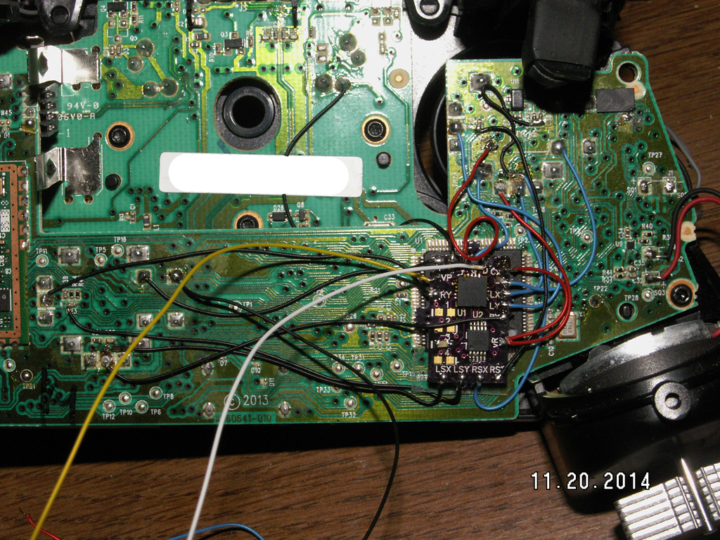

I did something like this awhile back for the 360 and XB1 controllers, but never made a PC side app for adjusting things as it was all done on the controller. They get calibrated after they are made, and installing new sticks or doing a Southpaw swap on them, especially the XB1 controller, just makes a real mess of things and they will drift all over. I quit messing with that project some time ago and never picked it back up as it was going to be a bit of a mess to install. I'm sure I could get it to be a lot cleaner, but it took a back seat to other larger projects here.
Are you lifting the 4 Wiper lines from the POTs? or cutting traces on the board?
I'm curious about the hardware you're using also. I see 4 Trim POTs on the breadboard, just wondering what they are doing? I used a 16F690 and a DAC104S for my design so the output of the Sticks went to the PIC, then PIC to DAC then the DAC to the controller board and the DAC uses the Stick voltage for the Reference, so it could be used on almost any controller that uses the same POT setup.
I cuted wires. PS4 controllers so bad for desoldering sticks analogs :) Metallized holes... It's hard to remove solder well.
"I see 4 Trim POTs on the breadboard" - there are parts of RC-filters for PWMs for each channel (release version will have constant resitors).
AVR havn't DAC on board. That why I need to convert PWM signal to analog signal.

I cut legs when replace sticks. But here sticks are well and I don't want to hurt them :)
I have 1206 elements only and now have some trouble to put PCB in body of gamepad :)))
Arduino Pro Mini have some place near motor, but additional PCB doesn't fit where.
Need to project new smaller PCB

You should be able to use a lot smaller Vias and components than 1206, unless you are making the actual PCB yourself?
OSHPark is a really great place to get prototype PCBs made and they are cheap, but they make great boards. Their specs for 2 layer boards now are Vias are 10mil holes and 5mil annular rings, then 6mil/6mil trace/space width, so you can get that board to half that size there easy with 0603 components that are still easy to work with.

PCB almost ready :)
Overheated right edge a little (temp sensor of hot airgun lost contact and temp quickly went to 450C)

Gamepad PCB part:

Nice looking boards.
You can do any of the 4 Stick layouts in your code now since your board is between the Sticks and controller. Default, SouthPaw, Legacy and Legacy-Southpaw.

Thanks.  Wire with fluoroplast insulation is great (MGTF names in Russia). Great to solder it and insulation not welding at all : )
