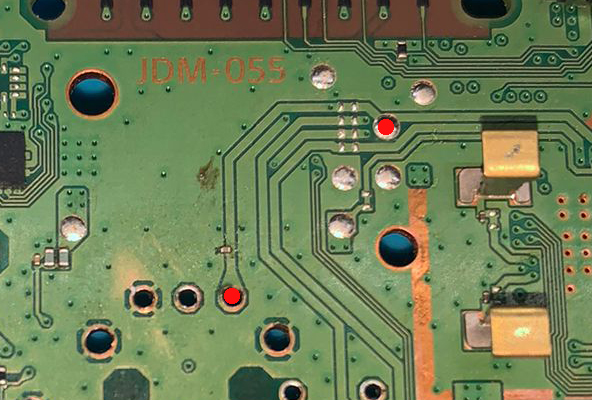

I wanted to repair L3 JDM 055 and broke the tracks in the attempt. currently in https://gamepad-tester.com/ it marks me as in the image, L3 AND R3 move to the left and up as soon as I connect the joystick
Can someone help me rebuild the tracks? It would be a great help.

Investigating I found that the L3 line is missing.
Where can I make a jumper to rebuild this track?
https://imgur.com/a/RmZnqcx
Thanks.

« Reply #2 on: March 04, 2023, 08:10:51 PM »
Install a jumper wire between the marked spots and retest first. You can also go from the top spot and go around the board to the back side and then solder it to the other spot if you prefer, just make sure the wire isn't going to interfere with anything when it goes back together.
