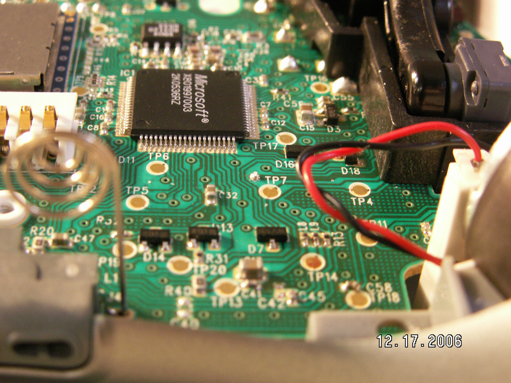

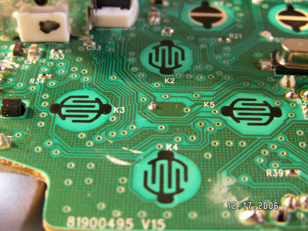

There was a via that liked to go bad on those Wireless Matrix boards that would open up and kill them. You couldn't tell from looking at them they were bad either. I used to use a pin vise and drill them out and toss a 30awg wire in there and solder both sides to restore the connection. No idea if that's the issue with yours or not though. It's been about 15 years now since I've worked on one of those things.

sorry.. im forgot  ask on this forum.. hahaa
just conecting two side right??
maybe im try using cable first before drill the board..
thankz for clue RDC

Yes the via just connects top and bottom together on that board, it has no internal layers.
