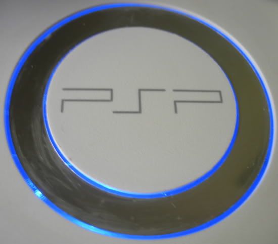

well I was mucking round making a ROL yesterday and found a new way to make it, Using the top lid of a pringles can, I thought it would be weak but after I ran a clear coat of PVA through the gaps it was as strong as the cd case method, but much less brittle.
I used a contact adhesive to strech the cut to size pringles lid over the UMD door.
Pics of outcome.
the finished product
up against the light
with single 0603 led behind it
tell me what you think

What's the back [inside] look like?
it looks pretty messy atm because of the glue I used, but if you use a clear glue it will look very clean

From outside it looks pretty clean and nice, i like it;  :clap:  but the plastic looks scrached!. :whoosh:
Re: New Ring of light plastic (method)?
« Reply #8 on: November 01, 2008, 07:20:29 PM »
thats just rings of light cept cleaner

can't make A tut this time round, but mabe next time. Btw LaCozTe you faild to state the hardest part, cuttion and sanding the umd door and the psp logo into perfect circles without a dremmel. Remeber this mod is pretty self explanatory, The pringles lid needs to be cut to size.

I had a dremmel... It broke, like a half year ago, and I have dealt without it.
I took off the silver ring, used the drill press to drill out the circle, and spent about half a hour on each side sanding it, then glued the lot up.
