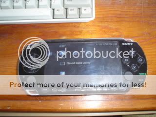

this is mine:
notice the yellow charger plug is still in place (and works too!):
