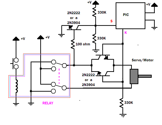

Offline FOOKzâ„¢
Re: controlling motors
« Reply #4 on: December 17, 2010, 06:27:05 PM »
*No Back EMF to worry about
*nearly isolated control circuit
*Speed control capability via PWM
*1 tact button control
(i wish i could test it but i picked up a free box of relays a bit back and just now found out they don't work  :eyebrow:  :x:)
OK here is a DPDT switch diagram:
You can do that same idea with a DPDT Relay.
Here is a circuit that i put together in like 15 minutes so yeah...
To code your PIC:
Your PIC is going to look for a Low on pin S. When pin S is High, pin K will be Low.
If pin S is low (tactile switch is pressed) make pin K High but when S is low then K is high for 3 more seconds to keep the motor ON so it can reverse direction.
« Reply #5 on: December 17, 2010, 08:44:53 PM »
WOW thats awsome you came up with that , very fast and looks very easy to make.
I had to read it twice to see what he was looking to do.....lol
nice work FOOKz
Offline FOOKzâ„¢
« Reply #6 on: December 17, 2010, 09:54:35 PM »
thanks rodent.
I want to test this out when i have a bit more free time on sunday night (no work! holiday break for 2 days :w00t: ).
I have a basic stamp thing and i'll go out and buy some working relays for future projects. [actually the relays i have are $12 each but i found them at my bro's company Phoenix Contact; he works logistics and we snagged a few boxes of free samples: LEDs, PIC chips, relays, regulators, ethernet connectors lol]
Adding a PWM speed control:
Just add 2 extra buttons right into the PIC chip where they increase/decrease PWM duty cycle. However a cap is going to be needed on the bilateral transistors' base.
The capacitor helps smooth out the nasty PWM signal and increases "non-real resistance" aka "impedance" on the base of the transistor.
The capacitor helps out by making the PWM signal less stressful to the transistor and motor. Capacitors also remove that jittery effect you see too.
please don't click spoiler if you get confused easily.
[spoiler]PWM works on the AC principle called "Volts Average" which is a DC related equivalent of AC by a factor of 63.7%
So a 1vPK AC Square wave (2vP-P) at 50% duty cycle will dissipate the same power and current as 0.7vRMS AC or 0.637v VAV DC.[/spoiler]
As Duty Cycle increases Volts Average increases because there is "more to go around".
