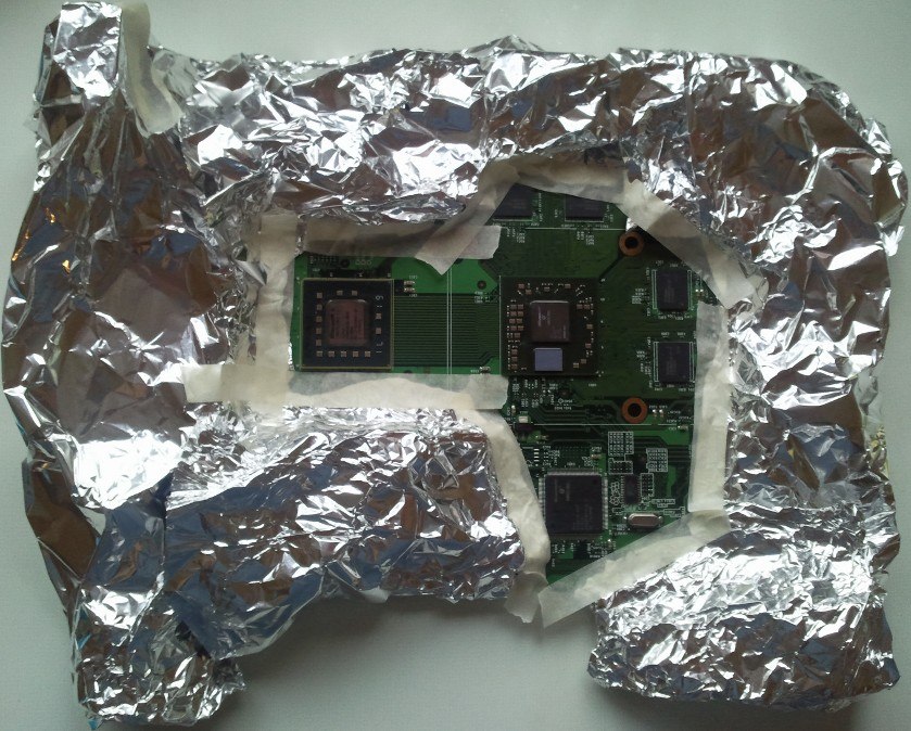

well. here goes nothing. im going to put a few layers of clear tape. packing tape. a lot probably. lol. and a few of the electrical tape. then a few of foil. i will take pics during. then in the oven she will go. nothing to lose... EXPERIMENT lol

well... its in the oven. i live in al. north close to tn and ms lines. im putting it in there for.. 1 1/2 hours on 175F.
pics after taping and foiling
and my rol :p webcam sucks at taking pics. but 1 player is blue, 2 is white, 3 is blue, and 4 is white and the center is red

still in the oven.. lol that last pic is from the one i am using now.

put it in for 40 mins 175 with door shut, and 5 mins on 400 with door open.. still no luck =/
i tried turning it on. still nothing voltages are right for standby... but i let it plugged up for like 10 mins and a chip started getting hot?? i took a pic and highlighted it blue.

that's the ANA/HANA chip.
