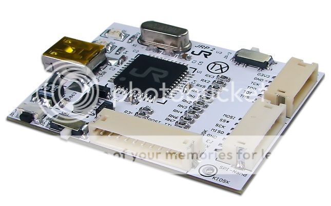

*The new J R Programmer v2 now includes full POST monitoring for the CR3 Pro RATER feature. Speed enhancements are also included that puts it within 50 seconds of the high speed NAND-X
NEW Version 2 with Full POST Monitoring and CR3 Pro RATER Support. Also includes speed enhancements (2-3 minutes faster than JRP v1 !)
The new TX J R Programmer V2 has been created to cater to the budget conscious and coded to work hand in hand with the latest version of the J-Runner app.
A third of the size of the TX NAND-X and optimized to run faster than any other USB-SPI PIC based tool (Example Speeds: Others average 16M read 7m 20s, JRP v2 average 16M read 3mins), this nifty tool can fully read/write NAND over SPI, program CoolRunners or any Xilinx based RGH device over USB and also able to program onboard sounds using the TX SONUS 360 !
Complete with a CR JTAG cable so you simply plug 'n program without any soldering using the latest J-Runner App (needs to be at least Build 283). Also comes with NAND installation wires that have the connectors that are compatible with the NAND-X QSB boards. If you don't use the QSB's you can simply cut off the connectors and do a normal wires only install.
The J R Programmer V2 is also fully upgradeable and can be programmed using the Xecuter X360USB PRO Update app. Onboard LED's indicate Power and BootLoader mode.
RED LED: Bootloader Mode (Switch to the left)
GREEN LED: J R Programmer Mode (Switch to the right)
RED LED FLASHING: R/W Activity & POST Activity (Switch to the right)
Features:
    Fast NAND Programming
    Fast XILINX CR JTAG Programming
    Compatible with all CoolRunners inc the new CR3 Pro
    Supports Full Post Monitoring
    Compatible with both Phat and Slim
    Onboard LED's indicate Power & Data
    Easy Install System
    Compatible with All NAND-X QSB's
    Includes Cable For QSB V3 Kit or Wires Install (QSB V3 Kits Sold Separately)
    Includes Cable For Xilinx CRJTAG
    Includes Cable for Xecuter Sonus 360 (Sonus 360 QSB Sold Separately – Trinity Kit or Corona Kit)
    Includes KIOSK option for Remote On
    Built-in Programmer For Future Firmware Upgrades
    Designed for the latest J-Runner App (Build 283+)
    Rock Solid Design – Tested by the J-Runner Team
    Supports New QSB V3 Kits (Solder Separately)
    Supports Sonus 360 Programming
    Affordable – We Provide You With More For Less !
    High Quality & Trusted TX Design
    Available to buy separately only $24.95

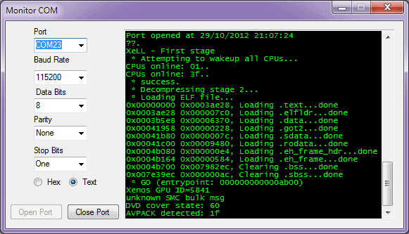

**The new V3 QSB kits also allow Xell monitoring over SERIAL/UART using the latest version J-Runner software (NAND-X USB Update Cable Required – we designed the software so it could also use this cable without having to design a new one). The new V3 QSB's are also designed to be Plug n Play compatible with both J-R Programmer & NAND-X and offer the cleanest and most optimum RGH install possible.
Here is a screenshot of the v3 QSB Xell Monitoring at work:

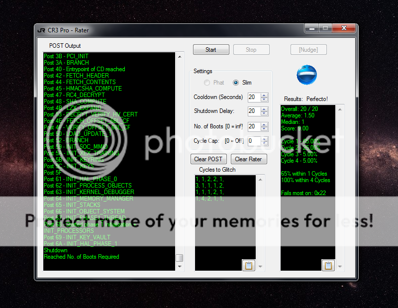

Not only do you have multiple tuning settings available to you with the CR3 Pro but you are also able to monitor and tune the performance using the much talked about CR3 Pro RATER Feature. No longer do you scratch around in the dark looking for your best settings, we now completely eliminate the guess work. Just look at these glitch times on a Corona! "

and this is the new Rater feature built into the J-runner app, it boots and reboots your console automatically and rates the install by how many cycles it takes to glitch, then from there you tweak it by changing the DIP switches and putting in caps with different values.
I ended up using a 10pf cap and switching DIP 5 and 8 ON
perfecto!  :clap:
