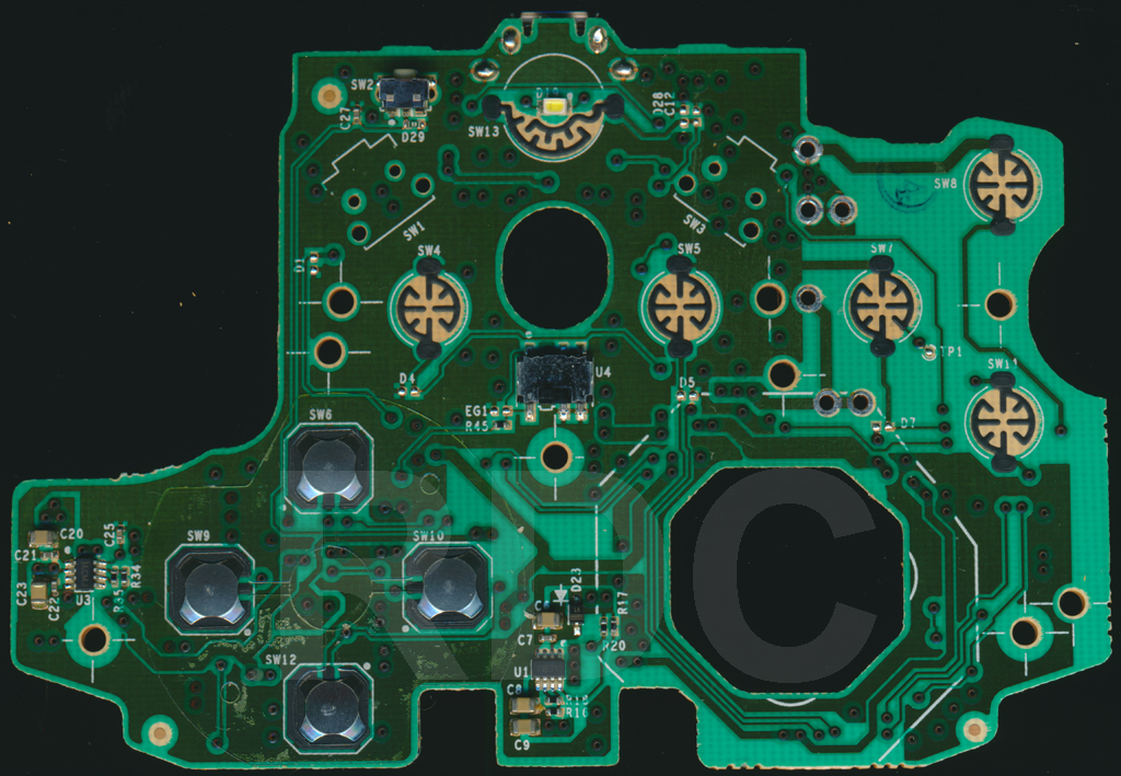

1698 BUTTON/POWER BOARD TOP
1698 BUTTON/POWER BOARD BOTTOM

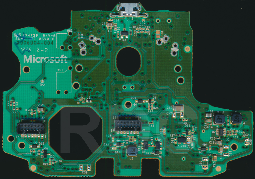

1698 MCU BOARD TOP
1698 MCU BOARD BOTTOM

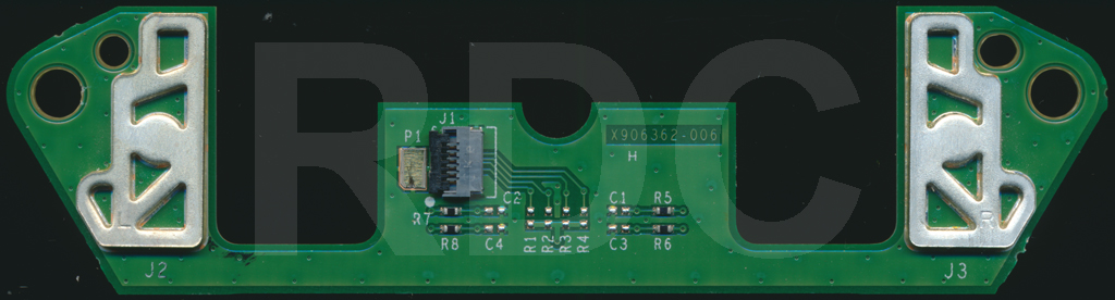

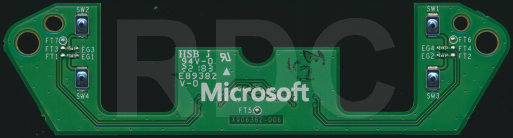

1698 ALTERNATE BUTTONS BOARD TOP
1698 ALTERNATE BUTTONS BOARD BOTTOM
J1/J5 Connector Pinout
1 - RUMBLE MOTOR+
2 - DR
3 - DU
4 - DD
5 - DL
6 - SY
7 - SWITCH (1 Grounded, 2 Open)
8 - 5v USB
9 - LB
10 - D+ USB
11 - POWER OK / SHUTDOWN
12 - D- USB
13 - GROUND
14 - GROUND
J2/J6 Connector Pinout
1 - V+ (3v Wired), (Battery Voltage Wireless)
2 - LED (under GU, does not drive LED directly)
3 - GROUND
4 - 3.3v
5 - RB
6 - GU (thru D27) Only Guide will work if J2/J6 pin 6 is used for new/alternate Guide button. Use Cathode side of D27 on Power/Button board or controller will not power on when it's pressed.
7 - USB Cable LED
8 - A
9 - X
10 - Y
11 - VW
12 - MN
13 - PNC DETECTION
14 - GROUND
BUTTON/POWER BOARD TEST POINTS
TP1 - Manufacturing test point of carbon film at SW7, X button, ~115 ohms to ground (top side test)
TP2 - Manufacturing test point of carbon film at SW7, X button, ~115 ohms to ground (bottom side test)
MCU BOARD TEST POINTS (some)
TP3 - RESET_b
TP15 - SWD_CLK
TP17 - SWD_DIO
TP21   - GND
TP89 - 3.3v
TP99   - LSY, goes thru R50 first, 1k
TP100 - LSX, goes thru R34 first, 1k
TP101 - RSY, goes thru R58 first, 1k
TP102 - RSX, goes thru R57 first, 1k
TP103 - AN+ (vRef)
TP104 - RT
TP105 - LT
TP106 - LSC
TP107 - RSC
TP110 - GND
TP118 - 3.5v (Rumble)
TP130 - GND
TP132 - GND
TP133 - GND
TP134 - GND
TP135 - GND
TP137 - GND
TP138 - GND
ALTERNATE BUTTONS BOARD TEST POINTS
FT1 - SW4
FT2 - SW3
FT3 - SW2
FT4 - SW1
FT5 - GND
FT6 - GND
FT7 - GND
