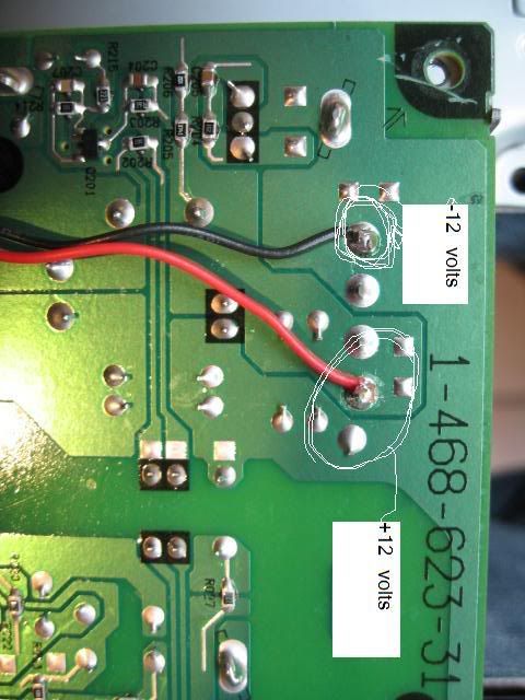

For those of you who want to mod a ps1 lcd screen or similar into a ps1, ps2 or ps3. F00 was the first person that i have seen who put an lcd screen into a ps2 and i was interested in how to do it so i asked him for the wiring diagram but he didnt have it anymore so i had to find the points by testing my ps2. This is not a tut its just a reference and ive never  seen a tut for this anyways. This is a picture of the bottom of the AV cable plug. so if you want to do this to ur ps2 jsut find the plug look on the bottom and u will find where u will be soldering. If u are looking to do this to your ps1, slim or ps3 just do the same thing, find the AV plug look on the bottom of the motherboard and u will see the pins. As for power on the ps1, slim and ps3 u have to find the points to solder to your self because i dont have them to find a 12v tap.
*I edited it, hopefully it makes more sense now if u have any questions pm me.*
i put in the audio for kicks and giggles
And here is the bottom of the power supply board of my ps2 fat
Happy modding  :cool:

is that for the slim or phat ps2, cuz i cant tell

Re: ps2 lcd screen mod
« Reply #2 on: December 19, 2007, 06:43:56 PM »
phat, says it right above the 2nd pic... looks like a v7/v8...

its for all of the playstations they all use the same video/audio plug which is what the pic is of(well the bottom of one)
the reason why i said that it was a ps2 fat on the second pic is because that is where u get the power from on just the fat. If u want to do this on a ps1, slim or ps3 u will have to find a 12v line because i dont have either handy to test
