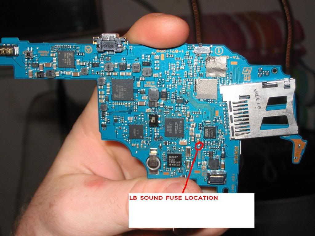

i have good news, thxs to tibor28 i manage to find the fuse of the speakers on the mobo.I accident broke the fuse of the backlight too -.-  ok so the backlight fuse is Labeled FB, while the speakers fuse is labeled LB. I will post pics after i take the pic.
Edited: NVM my cam suks canot see small stuffs clearly. But there is only 1 fuse labeled LB i think.

« Reply #13 on: January 12, 2008, 01:38:02 AM »
top or bottom? does that mean i just have to bridge it and ill be fine?  :dribble: OMG THANKS <3
Its just LB. yeah juz bridge it. Dun bridge the FB and u r fine.

U can take a picture if u wan of the 2 LB. But for mi The LB is beside the FB. 1-1.5 cm distance.
U check ur soldering, it should work. Now i got a new problem. The light mod can off and on even though it is in shut down mode -.- Loses a lot of battery this way.
Edited: I know why i doesn;t work for you. U muz have bridged the resistor infront the motherboard.It is suppose to be the back of the motherboard.

« Reply #18 on: January 13, 2008, 02:05:55 AM »
yea i did the ones in front. ahah it wasn't clear that its the back. thanks ! ill do it tomorrow  :tup:

« Reply #19 on: January 13, 2008, 04:28:05 AM »
YES it works !! <3

« Reply #29 on: May 31, 2008, 12:06:44 AM »
i know this is an old topic but i need to fix mine so  here is a pick of the location for the rest of you
