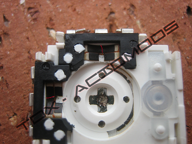

could this be that i accidentaly cutted the potentionmeters :S?
they are still touching eacother but this is what happend (the red lines)
as i said they are still touching eachother
« Last Edit: January 29, 2008, 07:50:45 AM by DubbleDutch »

« Reply #6 on: January 29, 2008, 10:40:02 AM »
ok i got the other retrocon stick
and i made it digital, everything works :) except for 1 thing
when i connect it to the multimeter left works, right works, up works, except for down
when i connect the multimeter to ground and to the down wire, it immediately gives a connection(so closed circuit) but when i push the stick down it opens the connection :S instead of closing it
any idea of what is happening ?
Re: Retrocon Questions
« Reply #7 on: January 29, 2008, 04:37:24 PM »
That means that the Y axis strip (when it was analog) or ground strip for up and down now that it is digital is shorting with the down side of the Up/Down strip
if your multimeter has pins for testing, turn it off, and dip on of them in methylated spirits or similar, ONLY up to the tip, and put it in the small gap between the strips and then run it downwards lightly dislodging all debris.
then dry it and your multimeter with a piece of cloth
« Last Edit: January 29, 2008, 04:46:36 PM by TimmyDX »
« Reply #8 on: January 30, 2008, 05:40:45 AM »
i fixed the problem (1 retrocon still not working)
the 2nd one is fixed
i opend the retrocon and cleaned it inside, and i cutted the gaps a little bit bigger
