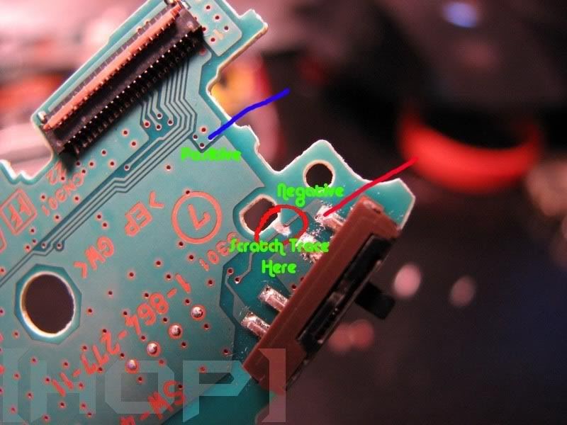

i recently bought a pack of resistors for the trigger led mod. so i have no idea which one is which, there are many different ones 10,22,33,47 oms

and can i have some pics to where to sodier my wires, please and thank you. because when i went to the tutorial the pics were brocken.

10ohm is the one with brown, black, black gold
The resistors goes to the positive wire

here is my pic and hop's pic... these are for the hold switch leds if you want the leds that turn on when the psp is on ask and you shall recieve

and any pics  for the wifi switch and the memory stick led where to sodier them.
Offline tibor28
  • Posts: 222
Re: A question
« Reply #6 on: February 05, 2008, 10:56:23 AM »
why do you need a pic for that??? You just replace the led!

isint it like you have to soder some wires to the motherboard, i saw it on youtbe,
Offline tibor28
  • Posts: 222
Re: A question
« Reply #8 on: February 05, 2008, 12:49:24 PM »
no, you just desolder the default led and solder a new one to the points
