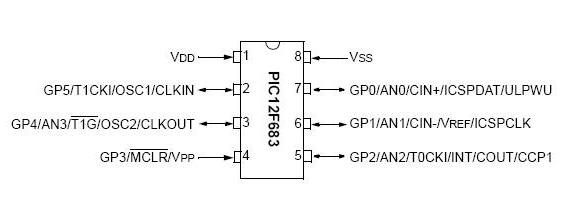

No, that code is not for the 12F683. Everyone on this forum uses the 12F683 including kingmike. To make the pin 1 (which is the 3rd I believe excluding the power and ground pins) high you need to put GPIO.0 = 1 for High

No, that is only for chips that have more than 8 pins. If it has 8 or less pins GPIO.0, GPIO.1, GPIO.2, GPIO.3, GPIO.4, GPIO.5, are all the input/output pins that it can have. u can't use port a/b on a pic chip that has 8 or less pins.
Here is a diagram for a regular 12F683:
