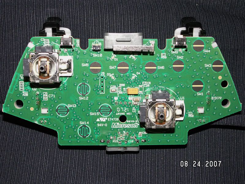

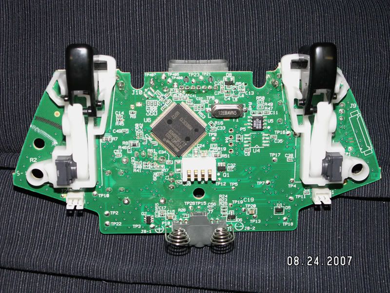

OLD 'MATRIX' VERSION TOP
NEW 'CG' VERSION TOP
OLD 'MATRIX' VERSION BOTTOM
NEW 'CG' VERSION BOTTOM
Pictures provided by RDC (http://forums.xbox-scene.com/index.php?showtopic=618909)

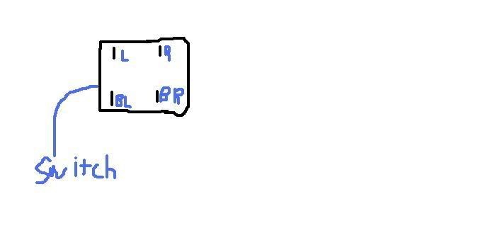

« Reply #83 on: July 28, 2008, 01:02:01 PM »
I get no results with this old stlye controller that I used....I'll keep an eye on the topic and see if anyone else gets it to work like you did...  :dntknw:
try swapping the wires on the switch around, its easy to get it mixed up especially if it is a 4 pin tact switch which looks like it is from what i can see in the video. if it is 4 pin then instead of soldering one wire to the left pin and one wire to the right pin, then solder one the left pin, and then one to the pin below it, if that doesn't work swap it around, use different combinations.
EDIT:
as shown in my amazingly drawn picture, try solder one wire to the Left pin, and then the other to the Bottom Left pin, if it doesn't work then swap them around. i personally believe that is the only reason it doesn't work for you as i don't think soldering may be the issue, just next time don't go accusing a mod is fake without having proper evidence to back you up.
Nemesis out.
