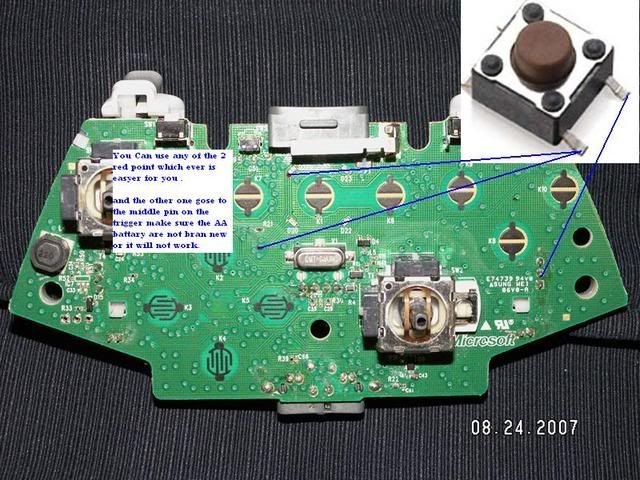

Ok I've tryed this and it worked for about a second but i figured out it was a connection problem. in the process i lost my player 1 LED. my question is as shown in the picture has anyone tryed it with the second grounding location on the board? if so what are your results. thanks alot

Can someone please let me know where the ground is on the led? i cant find it anywhere and have tried to attach to to many different things. Can somone upload a clear photo of where to solder it? Thanks alot!
Re: New Rapid Fire Method (No Chip)
« Reply #281 on: August 12, 2008, 06:40:19 PM »
here.....

I have seen that image, i just dont know where exactly to solder the wire, to the left side of the led? or what, i need an exact placement because its not working, and has anyone used the other spot instead of the one near the led? please a quick repsonse would be apreciated

FrankieB4 the ground is on the left of the LED, and thanks Blazinkaos  i have no problem waiting i have to work as well so i'll be checking back when i have chance. I'll be sure to get that 15-20 soldering iron and i have the 30 guage wire now. thanks again.

the two ground points in the tutorial are both on the same trace meaning there is no difference solder to the easier of the 2.

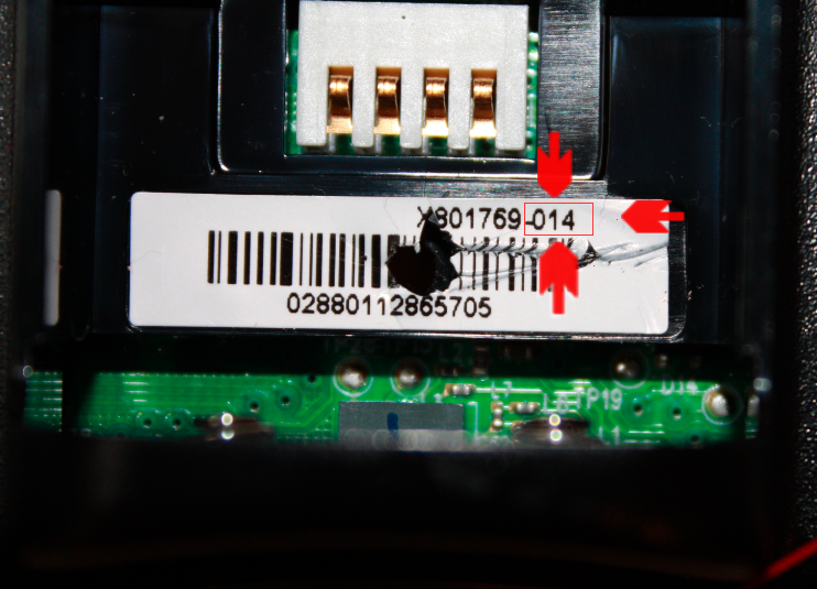

there are different "old style" controller boards.
-016 works with led ground
-014 will not work with led ground, it will work with rumble(not sure how stable)
if you do a controller please add to this list.

Where do I look for 016 or 014?

« Reply #291 on: August 13, 2008, 10:19:33 AM »
Yea that what id like to know...

look under your battery pack for a barcode
Right under the battery pack for example FrankieB4 pic shows the barcode see were 014 is in red...

but my barcode is 009? so how does that work
