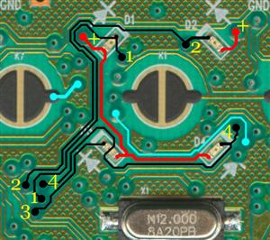

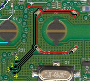

I do not have a wired controller to test this but below are a few pictures of the ring LED layout on the controller,  it appears the connection points are different.   I did not take these pictures, I found them on another website.
Wireless layout
Wired layout
It seems that if you wired to the to either spot on the board marked with 1, or the right side of the LED it self this would work on a wired controller.    Has anybody tested this?

« Reply #380 on: September 16, 2008, 10:07:08 PM »
yea well this mod is very easy and if the lights dnt light switch the led around thats what i did and works great and very glowy too.
But good pics did make those SplitboXer or did u find them.
