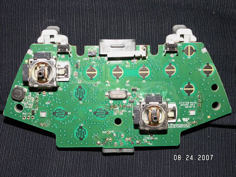

LOOK FELLAS, I have been reading the posts for a while now and it seems people are having problems and issues with wiring the momentary switch to the LED or the other "reds" on the board. Well I am going to tell you the easiest way to do it. DO NOT even mess with the LED or any other place on the board!  Follow these easy steps.
1) Go to radio shack and buy a momentary switch, and nothing else.
2) dismantle the controller that you would like to use
3) remove the right rumble (as you are looking at it as it is sitting on a table with the back up)
4) cut the wires off of the rumble
5) cut the plug off of the rumble wires
6) solder those wires on to the momentary switch
7) drill a hole where the rumble was, and mount the switch
8) take one of the wires from one side of the momentary switch, and solder to the middle prong on the trigger (just like everyone else does)
9) SOLDER THE OTHER WIRE FROM THE MOMENTARY SWITCH TO THE BOARD WHERE THE RED FROM THE RUMBLE PLUG GOES THROUGH THE BOARD! (if you solder it to the black side nothing will happen when you test it. It will shoot normal. No big deal remove solder and solder to the other prong.)
10) test
11) reassemble controller and enjoy.
If you want, you can just mail me some money as props! LOL :clap: :hifive:
There you go its that simple and it will cost you a whopping......................... $2.00 !!!!!!
