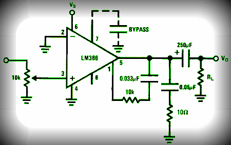

Can someone please tell me what the circled areas are? is this where the SM LED's go? Can this mod also be used to amplify the internal speakers of the Slim and the LED's at the same time??

Yes that is where the LEDs go, this is the sound reactive mod using what I am assuming is the LM386, I didn't know there was two LM386 chips needed but I guess it makes sense now I think about it. Anyway, trying to amplify you internal speakers probably isn't the best idea, the internal speakers are designed to go to about the volume they go to and no higher, you can however fit a another speaker or two if you so wish but have a look around and look at some other threads, this has most definitely been done before.

Why cant this be put together like this? What r the gain and bypass legs for on both sides? You would have to build one for each side. :dntknw:

Have you ever seen a chip with 7 Legs instead of 8? Yeah me neither, that's why they put some extra pins there from time to time.
The symbol you circled are the LEDs, also it's SMD LED not SM.
Also yes, it can be put together like that, but that would be mono, meaning the LED only displays  the sound of one speaker, the other picture you posted first is for stereo, meaning the leds react to the music coming from each speaker individually.

Ok, first, in the top picture you are looking at the stereo set-up of the sound reactive mod...  the symbals are the LEDs, the two arrows respresent light being emited by the LED, normally the arrows are rendered in the color of the LED used, but since this is up to the end user I drew them without a specific color...  If you take a look at the LM386 Data Sheet, you will see the internal gain is 20, but using the Gain pins (Not going to go into the exact method of doing this) you can set the gain to whatever you might need...  The Bypass pin is just that, it can be designed into a circuit to bypass the IC...  In order to design an effective speaker amplifier circuit, i would sugest you search for the LM386 Data Sheet on google and start with their suggested circuit diagrams.

+20 GAIN FROM CHIP
+200 GAIN
BASS BOOST
The gain from the chip itself internally is set to +20 without any other capacitors inline which I think would give the internal speakers a good sound. You can also make it with a bass boost but I dont think the internal speakers could handle any more bass that what is already handled.

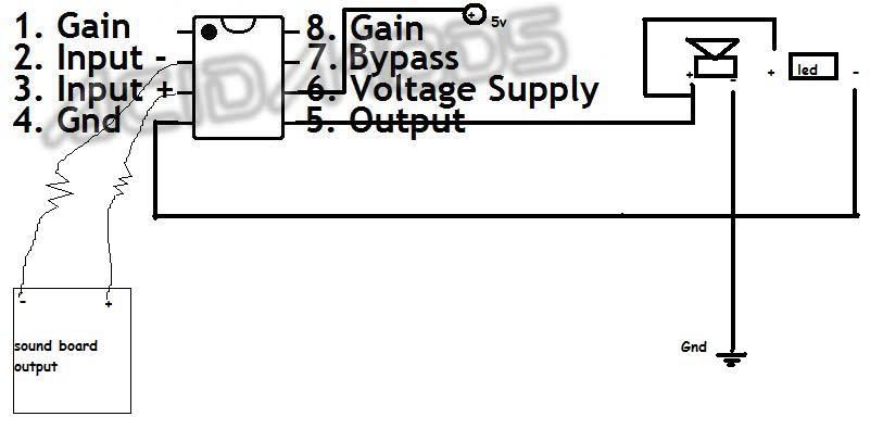

Why cant it be done like this? Do u think it will damage the internal speakers? I dont see why it wont work. If you do this per speaker then the LED's will flash according to the sound on that side(speaker). Am I correct?

The LEDs will blow, the speaker might break if it isn't rated for that.

How will this blow the LED's when its pretty much the same setup that L0rdnic0 uses except I added the speaker on the other side???? :dntknw:

In your last diagram, where you have the speaker on the output side of the LM386 would work but you would blow the PSP speakers the first time you turned it all the way up.

l0rdnic0 's right you know. it works well at a low volume but not when you turn it all the way up. I've already blown my speakers because of that. however i could still get sounds thru my headphones
