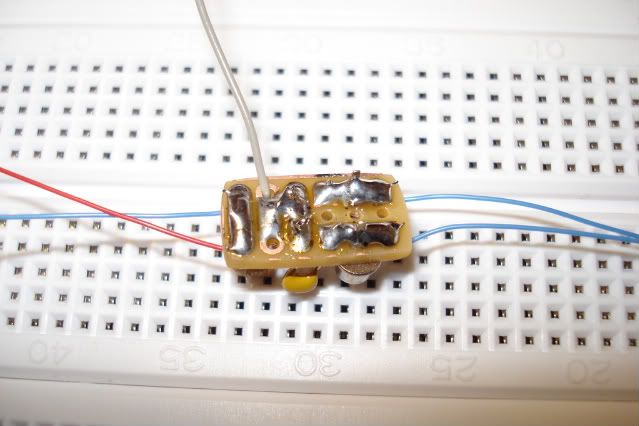

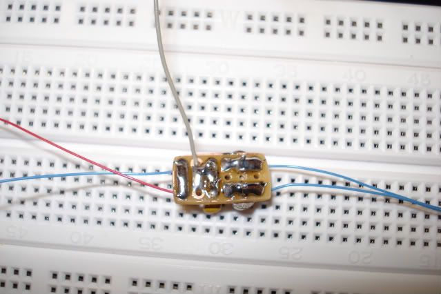

Cyber, is there any way I could get a pic of the underside of the crystal timer? The pics you posted are of the same side (or at least appear to be). I don't see where the capacitors are soldered to and where the little silver piece is located. Please, if anyone has a pic of the underside of the crystal, can you post it up so I can proceed to attempt this. Thanks

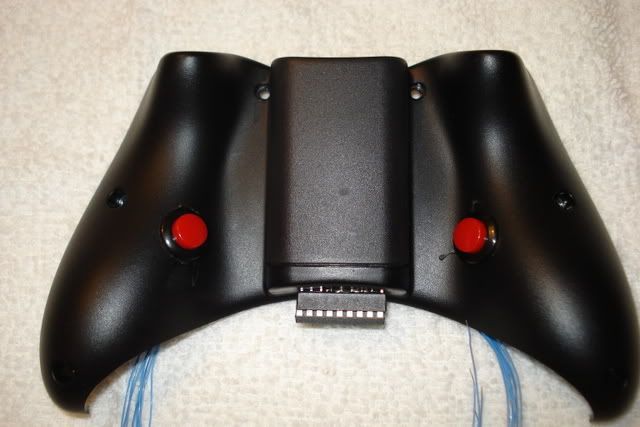

im going be finishing up the initial controller shell modification with the 18 pin socket on wednsday, i assume none of the controller shell modifications are going to change except the wiring to the pic in your new tutorial? (Hopefully i can get the pictures of how it turned out posted on wednsday night or thursday)

Here is a blow up view the crystal is on the other side..
^^^^^Could you provide a picture of the other side of this for me? Two pictures were posted of the same thing and I need to see the other side before I proceed. Thanks^^^^^
  • Site Founder
  • Posts: 4091
Re: AcidMods SpitFire 360 Controller Tutorial
« Reply #39 on: April 28, 2008, 07:50:52 PM »
I did not take a picture of the other side but Nico has detailed pictures..

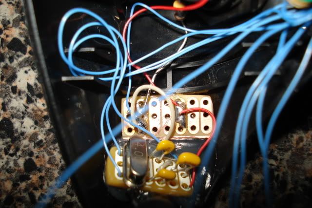

I can post the picture of my backside, the internal Clock Today .
Just need to take a picture

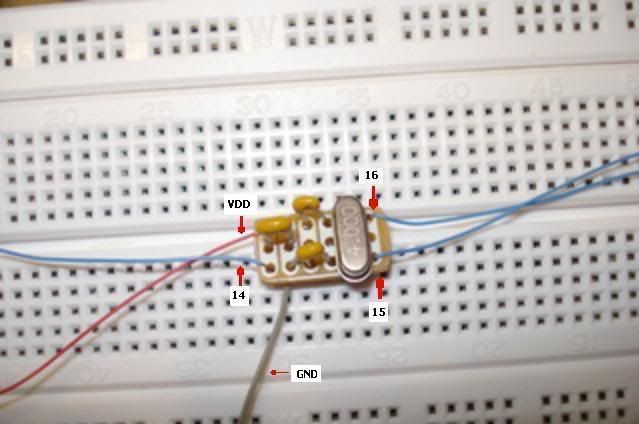

I cut the trace on 3 of them before i start
Blue Wires : Pin 16, 15, 14
Red Wire VDD
Gray Wire GND
« Last Edit: June 06, 2008, 03:56:30 AM by KingMike_OS »

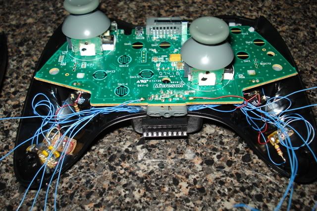

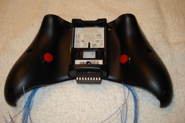

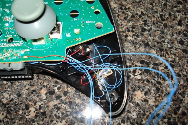

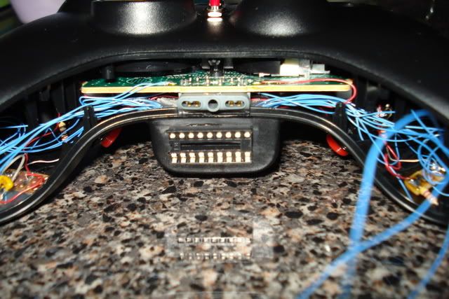

Here Some more Picture of My Controller
I'm not happy with it i could of done better oh well my first one

« Reply #45 on: April 30, 2008, 11:21:40 AM »
Here some more Picture

« Reply #53 on: May 03, 2008, 03:42:21 AM »
I got it done Finaly i'm gald it over now i can start on the new project hehe
Thanks for the help Cyber and Neco  :dribble:  :#1:

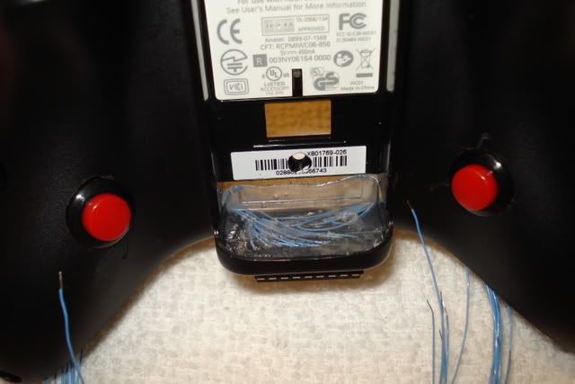

Ok Vdd is the + you get it from the controller Board i use the Mic Area if you look at the picturs all the VDD are red Wire for hot +
also is 150.00 too much, it's lot of work already wiring 18 pins and making it all fit in the case and work .. how much did you have in minde ??
2nd Question : X801769-026     COD4-Basic-All-Models
the 1st one is for that controller board if you take the battery out there is a number
which is in this case X801769-026 use that hex file for dose  which is for COD4
and for all other controller for COD4 use COD4-Basic-All-Models hex file
The rapidfire is the switches that wire to the Pin 17 / 18 one of them will be rapidfire
