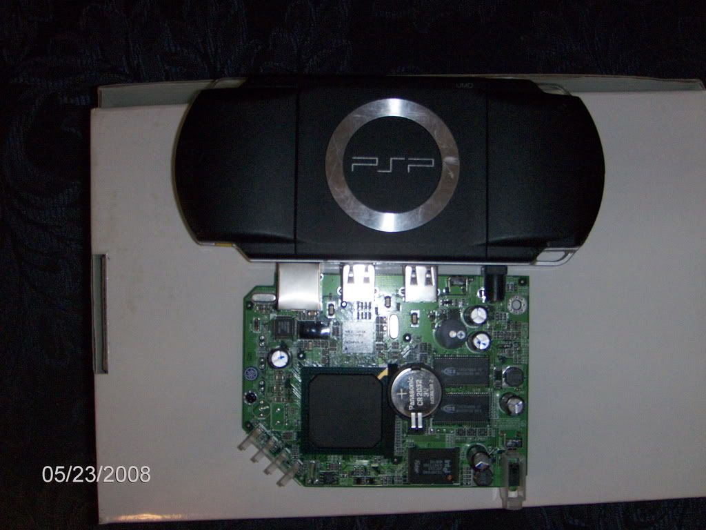

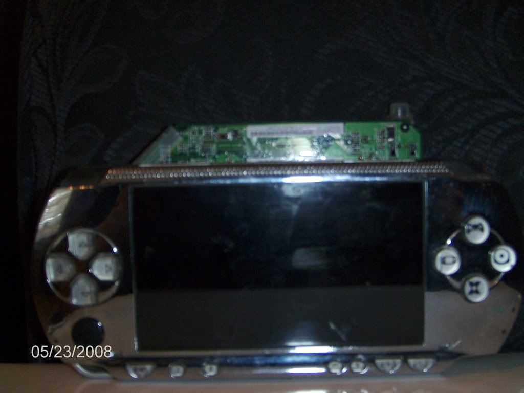

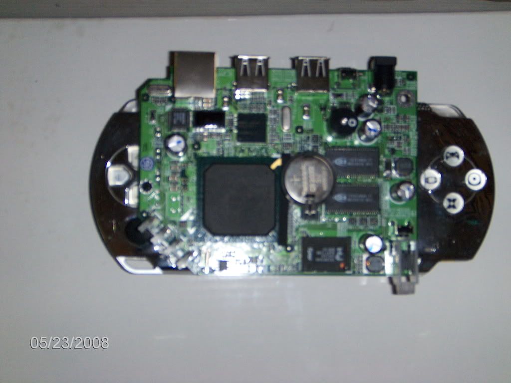

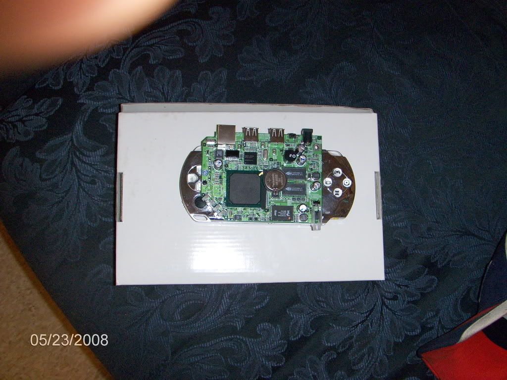

Offline unicorn
  • Posts: 11
mongol550 the motherboard for the nslu is too wide, it wider the the psp (about 1 3/4) i see no way to make it fit in the psp plus it's longer then the umd door. but i got mine working, it work great with slugOs install and runing usbhost.
but since its to large to fit inside i am willing to sell it. i am also selling my vdip2 and the e-val board , so let me know if anyone is intersted i will sell at a lost, need money for my new mod that is going to cost around 600 in supplys.

As I can see it on the picture you can try to cut NSLU a little ;) Desolder USB ports and LEDs and see what can be dremeled. Also I think you should make little box on the back of PSP. You can put here HDD.
Offline unicorn
  • Posts: 11
still wont work the psp is 2 7/8 h * 6 3/4 (the actual umd drive is 2 7/8 h *  2 7/8 w ) the nslu is 3 3/8h * 4 1/2 w)
even if you desolder the two usb port and the ethernet port and power port you still don't have enought room even if you dremel as much as you can of all four sides. width wise you might be able to do it , but the long side it be to much work, to many resistors and traces on the under side of the board  to cut and jump. it can be done  but i personely would'nt wast my time on it ,
but the nslu does work great with irshell and would of been a great solution for adding a harddrive to the psp.

Offline hdx
  • Posts: 30
Can you make comparsion photo of PSP and NSLU2 board?
Offline unicorn
  • Posts: 11
here is the comparsion photo of PSP and NSLU2 board

Offline mongol550
  • Posts: 11
 So now its confirmed that the NSLU2 is too big to fit in the PSP, and I'm assuming you wouldn't be able to cut off some silicon because theres no "blank" areas on the circuit board where theres no components. Though it does look like you could run it fine with only the HDD inside and the circuit board held onto the back with rubber bands or something.
