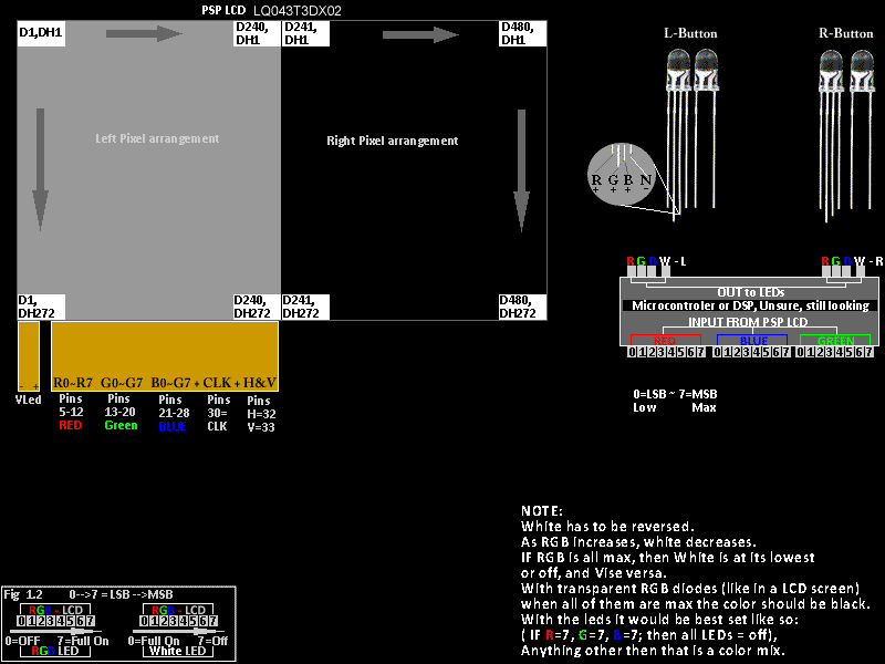

« Reply #12 on: June 24, 2008, 12:48:40 PM »
Just an update! Letting you all know I haven't given up on this, just now starting to work the idea out. To much RL going on to start when I wanted to. May also add to even more delays down the line.
So far on paper this is the basic Idea I have down and if anyone would like to add to it or point in another direction feel free to do so.
more info on the LCD can be found here.

Nice diagram Devilbeast, good to see more progress being made on the project. I am a little confused by the reversal of the separate white LED though, isn't white produced from the LCD when R, G, and B are at their highest intensity? If this is true, then white could be produced by the RGB LEDs without the need of separate LEDs dedicated to it. I think we will also need the clock and H/Vsync lines running to the microcontroller in order to isolate values of different pixel ranges from the screen.
Using sensors to obtain the color values will ultimately always leave us with the problem of where to fit them, although it would be cool to see this in action. The code to drive the LED color is needed regardless of how the values are obtained, so I think this could still be useful for the LCD method as well.

Actually LCD is quite the opposite. An LCD screen is nothing more then a Light Filter. Where a LED is a Light emitting. Here is a simple way to explain this.
Take a flashlight, It acts like your white light behind an LCD screen. Next get 3 sheets of tissue paper or clear colored paper. You need 1 RED, 1 BLUE, and 1 GREEN. They act like the LCD itself with the RGB color pallet filters.
When you put each color in front of the flashlight you get a different color on the wall, but if you put all 3 on top of each other you get nothing to almost no light at all.
To simulate LED just add 2 more flashlights. The 3 flashlights each have 1 of the 3 colors point them to a single point on the wall and you should get close to white.
This is also why a white background on a PSP will last longer with the battery then a black one will.
Finally I think your right on needing the CLK and H/V. If you look at page 14 of the PDF you'll see the top diagram giving the data signal for D1~480(pixel 1~480 left to right) and lower diagram dh1~272(Pixel 1~272 top to bottom). I have represented this on my diagram if you look at the white boxes.
Now I think the easiest way to go about this is setting fall off points on the left and starting points for the right side. Example would be L ≤ 240 , R ≥ 241 at any vertical point.

Devilbeast, I understand what you are saying, but this is true of normally white LCD displays, whereas the PSP LCD is listed as normally black (datasheet page 5). In this case the screen will be most opaque when voltage is not applied, and will gain transparency as it is. The chart on page 15 of the datasheet shows the 24 bit configuration for displaying each color, black is low level voltage across all lines and white is high level across all lines, the same applies to the individual color grayscales.

« Reply #23 on: June 26, 2008, 11:52:39 AM »
Damn Your right Blizzrad. Thx for catching that. I'll make the diagram changes this weekend.
Now going back to PWM, (I don't want to stick with one idea to go about this, and make it as cost effective on the design side as possible.) I've been looking for documentation on the psp side that you said Cyberpyrot might of posted but I can't find anything  :confused:, even from Google search. Would you happen to have a link or links pointing to this info? Keep in mind I'm not looking for PWM info on the audio side just video. If its raped into one thats fine also. Thanks ahead of time.
(TO: DubbleDutch) Guess I can't take claim then on the idea for the psp but lets see if WE can take claim on making it happen.  :drunk:
