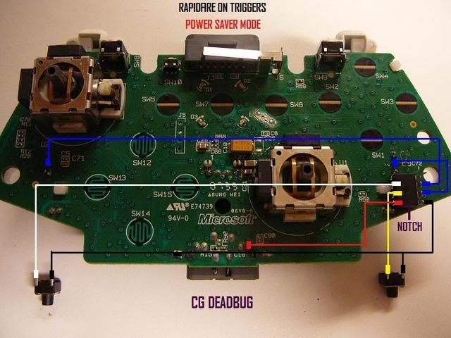

just run a ground for each switch to the same point that the chip ground goes .. they all the same so they can be conected to each other ..
or you can run them one by one so you have 3 wire on ground one for the chip ground pin 8
one for the right switch ground and one for the left switch ground

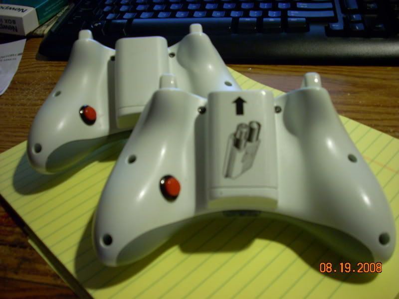

Mike, thanks for all your help with my delivery the other day (this is Tom in Seattle), I appreciate it! I ordered a few more chips the other day!
A quick question on the ground. I have done 6 of these already and have soldered one wire to the ground point and to one pole on the switch. Then I soldered a wire from the same pole on the switch to the pin on the chip. I found it was easier to solder multiple wires to the switch instead of the board or the chip. THe mods work great! I use a different switch because I like the bigger buttons, here are a few pics of some of the controllers I have done. Most of them I just did the rapid fire on the right trigger.

ok guys i now need some help i was trying to install the rf on the triggers and use the buttons to turn them on/off well i got it to work and was playing with it last night but this morning i noticed that i left the rumble motors out so i installed them and now my controller doesnt work any reasons
Re: Wiredinput Installation Diagrams" RapidFire Dual Triggers Old/New Board Styl
« Reply #48 on: September 21, 2008, 09:58:12 PM »
u sure u installed them right..

hello, i ordered 2 of the https://acidmods.com/ShopUSA/product_info.php?products_id=79 based off the diagram the black wire shoud go to each trigger but there is only 1 wire. Also, there are 2 wires attached to each button, so am i supposed to attach them to the other prongs of the button?
« Reply #50 on: September 22, 2008, 10:56:54 PM »
ok bro very simple the black wire u just wire one wire from trigger to the other then u take another wire solder to the trigger and the same spot as the wire to the chip.

yeah my problem was the black wire going to the bottom/middle part of the board i didnt see that but fixed it thanks

Hey, i bought 2. I have done this mod before with other kits and it has never been this hard here is the instructions for the other mod kit http://eternalgamers.org/rapid.pdf .... i have done everything as it says and for my dual rapidfire, the left switch turns on the left trigger..... and the right does nothing, pleas help me out. here are some pics: http://eternalgamers.org/1.JPG http://eternalgamers.org/2.JPG
