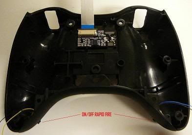

I decided i wanted a internal chip, but i also wanted easy reprogeaming, so i looke through all my goodies laying around, and i found this wii modchip called a wii-boss, its a small pcb with a smt 12f629 on it (but i replaced it with a 12f683), and has a molex connector for a ribbon cable, and it comes with its own programer.  heres a few pics.  the wii-boss chip is not sold anymore, but if theres interest maybe we can get some produced if we can find for decent price, i used to be able to but these for $10.  Prob still can get some from the creator of the chip but id have to buy atleast 10.

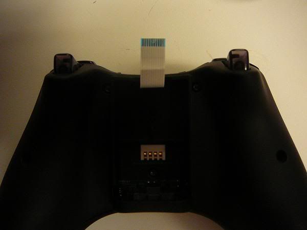

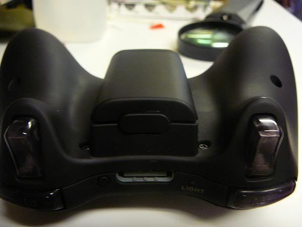

When my 2 inch ribbon cable come in it will exit the hole marked and hide behind battery when not in use.
Easy connection for upgrade of hex.
Programmer that comes with the wii-boss chip.

Got my 2 inch ribbon cable in, and heres some updated pics.
