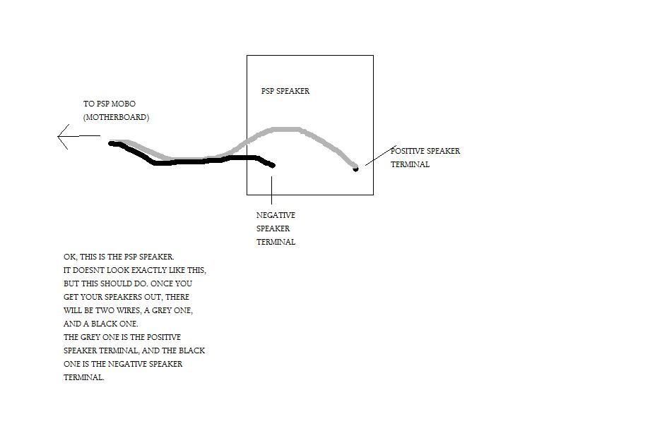

how 2 noe which part is positive or negative
Re: psp speaker mod
« Reply #33 on: August 11, 2008, 10:45:53 AM »
Just test it....
Put the 2 wires ont he back of the points of the speaker and you will know... :x:

hi i have a problem to do with this. im not new to modding just need sum help. so i have a speaker,and my psp (which is in pats, but i will put itback together.) so what do i do now?? :dntknw:
this has been explained lots of times before. take out the umd drive, next dremel out a hole in your umd door, fit the big speaker in the door, solder the two wires from the big speaker to the contacts on the psp speakers. the picture showing the positive and negative points is 1 thread below this one in the same section it was started by the same guy.

« Reply #44 on: August 23, 2008, 05:13:01 PM »
Dont  :censored: about the size, i was too lazy to resize.
