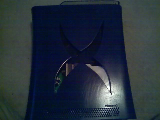

Thanks alot guys. I got it :) Heres a pic of what it looks like, sorry for the crappy quality its a phone camera :P

« Reply #13 on: August 26, 2008, 03:32:19 PM »
Nice job.
Now you got to do your controllers. Those are easy. Then show it off to your friends and charge them a few bucks to do theirs.
