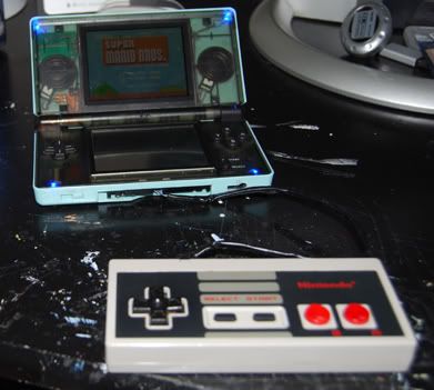

im sure it has been done before, but i want to make an external NES controller so i can play roms on my ds
thanks for any help guys!

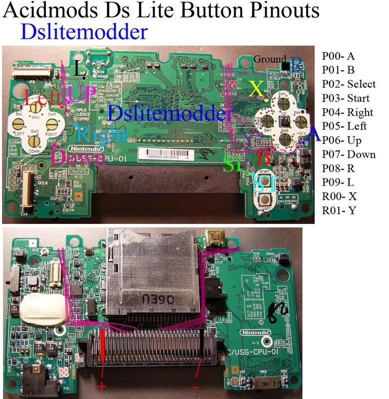

I don't have a pinout diagram for the slot two, but I do have the pinouts for everything else
https://www.acidmods.com/forum/index.php?topic=21933.0

suppose i can always solder the lines from those points to the slot 2 and use that as my "usb" connection
these pin out connections, is it as simple to just hook up a button to them, and it triggers them, or do i have to hook 2 wires up with a button, how does that work, so far i havent found explanations
Re: external NES controller
« Reply #3 on: September 01, 2008, 08:47:49 PM »
you can hook them by connecting the button to the point and a ground.  you can get an ipod connecter at sparkfun.com and wire it all up to a common ground if you want
Offline thecauseandeffect
  • Posts: 38
« Reply #4 on: September 01, 2008, 09:21:18 PM »
oh
so the buttons are just open connections to a ground, and when you press the button all you are doing is closing the connection?
i never knew that...this is going to be easier than i thought

Do you mind if i remake this pic so it is clearer? i will give you due credit, and i am also going to add some other points i found poking around.
Go ahead, just make sure you give the others credit too.

Why don't you do the last 4 buttons that way you can hook a different controller up later, if you wanted to.

« Reply #15 on: September 04, 2008, 12:41:51 AM »
YES!
finished!
it works beautifully too!  i will upload pics later, although i can imagine you all know what it is supposed to look like.
time to finally sleep

run the wires from each pin out to a GBA pin, it doesn't matter which order you do it, i did every other pin just to make sure they didn't short out when soldering and such, but you don't have to.  starting from anything after the third pin on the left and second pin on the right, be sure to write down which button those will represent.  just name them by the
on the controller find the ground that connects to all of the buttons, then run a wire from there to the ground on the GBA cart (2nd pin from the right). then find where each button is running to.  from that, wire the the button in the SNES controller to the corresponding pin on the GBA cart.
same thing to do the NES controller except from my start button on the controller.  the DSTT requires you to push "a" on the NDS to start the games, and the NES emulator uses "b" and "y". so i made my start button also trigger the NDS' "a" button so that i could completely control the DSTT menu from the controller.
so yeah, its all very simple
