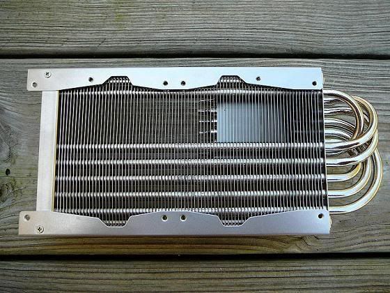

here is the card i have
and im installing a t-rad 2 with 2 - 92mm fans, here are some pics.
now to my problem, if i wire the 2 - 92mm fans to the 12v rail i get the blue screen of death on xp, but if i plug in the stock fan the card works perfect, can someone tell me how to hook up the       2 - 92mm so that the card will work and stop giving the bsod, so i dont need stock fan plugged in.  the 92mm fans are 3 wire.
thanks for any help.

ok, i uninstalled everything.
so i put gpu in no software, no drivers, and it works.
install driver - still works
but when i install catalyst control center it starts doing same thing again.
