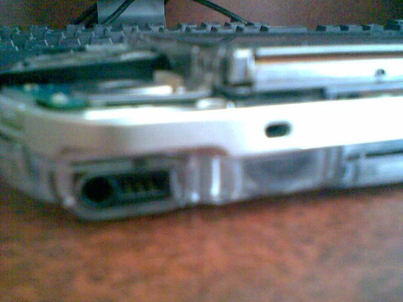

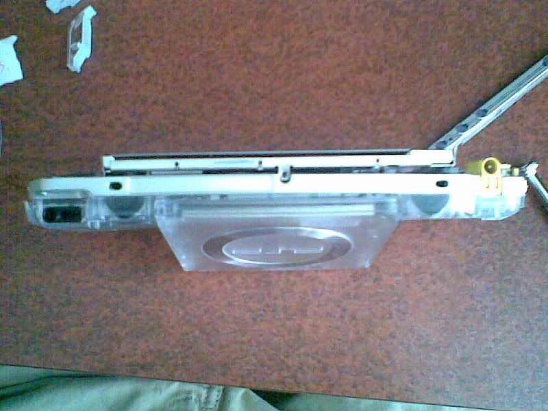

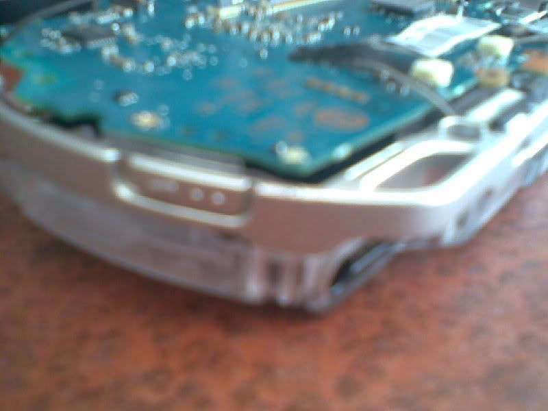

Okay I've put everything in the new case and all I have to do is put on the face plate but the face plate won't fit, in the bottom left corner of the psp is a little higher then the rest, I've checked under the mobo and I just can't figure out what to do :-(
Pictures coming in a minute.
Oh and it won't turn on either :-(

Here's another pic, I'll try that.

try to get the mobo more in. if you take it out again make sure everything on that side is in properly.

Thanks, it was my mobo metal case thing under the mobo that wasn't all the way down.
