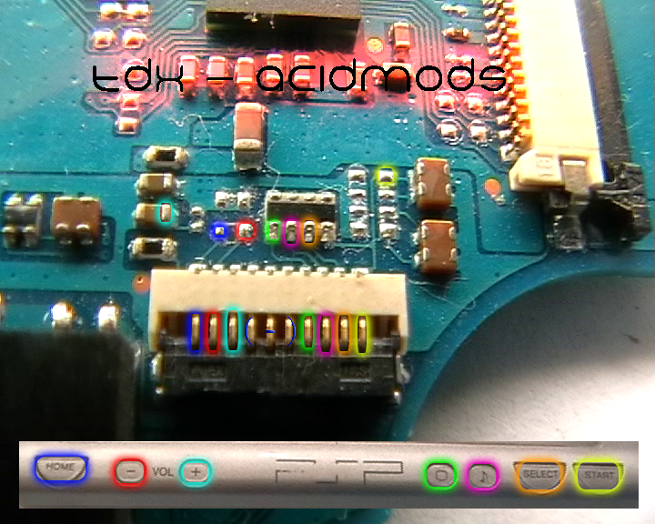

Okay, so i made these AAAAAAAGES ago but only posted them in R/D
What are they? Pinouts for all of the buttons in the psp slim
Not just points on the ribbon connectors ;) bigger spaced out points all over the mobo for those tricky controller projects
Enjoy
theres other stuff i didn't get like the serial port and power switch but that wasn't the goal so thats all folks :D
Also as for ground points that aren't on the ribbon connector.....there all over the place....in huge plates

Haha, yes..all over the mobo being less than half a centimetre from the zif connector.
Those are nice points, but I prefere to just solder all of them straight onto the back of the zif.

Yup its hard, almost broke my slim's motherboard first time i tried. :fear:

and yeah go for it dslm and alien yeah i guess so i just meant more so then the zif, i used a combination of the two when i tried it out
