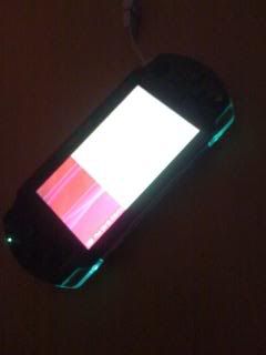

hey guys i just finished bridging a fuse to get my psp working again. i also added custom firmware(4.01 m33-2). i had to make a pandora battery with a switch for that. i also added the usb charge mod, and sound reactive triggers. now this was the very first time i've ever touched the innards a psp so now my triggers don't react anymore unless i press harder. i assume this is the hot glue on the leds of the buttons preventing its movement. are there any other possible reasons for this? also please take a look at my lcd and tell me if i have damaged my screen/ribbon cables or if have damaged my motherboard. because i did break off the tab which locks the smaller ribbon of the lcd in(is this cable the backlight cable or something?). although i keep that cable in place with electrical tape now.
here it is on boot up
this is when it's on the homescreen
the white, blue and pink split on the screen
thanks for helping me out guys!

hmm, that's weird... Try a new lcd. It shouldn't be your mobo if all you damaged was the little tab, and not the actual connector. If a new lcd doesn't work, I dunno what to tell ya.

Np. But to be honest, I wouldn't buy a new lcd from dx, as they aren't oem, and I heard quality isn't great, and shipping is really slow. If you were actually planning to buy one, I'd get it from ebay from a respected seller. I do think it's your lcd connector/the lcd itself, because there seems to be a problem with your rgb balance or something. Oh and extra parts are always good. You never know when you'll need one, and if you're tight on money, you can always resell it to any of our members here on Acidmods.

i know whats wrong that happened to me the ribbon on the screen is snapped or broken somewhere. hope this helps!!

Maybe its you zif (zero insertion force ) that maybe broke or is having a bad connection with you screen and whats wrong whit your leds is that they maybe  got unsolderd

Yes, this may be the problem, also. Either way, I'm pretty sure that buying a new screen will fix your problem.

try the screen in someones elses psp, or buy a busted one for like 50 and try it. if the screen works, then its a zif connector, or mobo problem

ah dude that stinks. id say  its the mobo cause you still see things on the screen. if you want to, you can send it to me and tell you if its mobo or screen. ill put it on my phat, if it gives me a problem, its screen. if not, its mobo

hey if your still having issues, i was having the problem on one of my Phats. Try just cleaning off the ribbon contacts with some kind of cleaner (i used a very scarce amount of windex) and then get a fresh paper towel and wipe it off again. Then when reinsterting it into the connector use your fingernail and lightly push in the middle and outside edges and flip the plastic clip down while holding light pressure on the ribbon. This fixed my problem!  :#1:

It is the 40pin Zif connector on the motherboard, or the LCD.
The screen isn't making full contact with all of the RGB output pins.

I don't think this is a ZIF connector issue, if any of the 24 RGB lines were not making contact the pixels would be equally affected throughout the entire screen. Something is probably wrong further up in the LCD hardware, possibly some damage to the ribbon in the fragile area where it folds around the glass.
