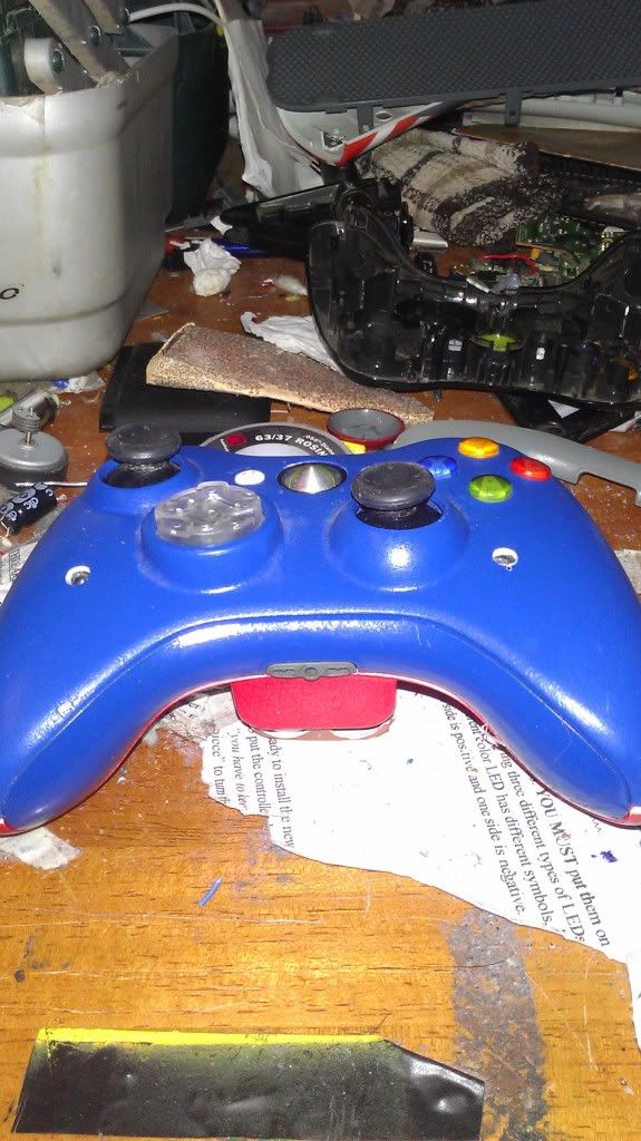

I just got back into Xbox modding after years, and I love it.  Idk how alive the Xbox 360 modding community still is now a days, but it's fun.
I'm gonna re-do this symmetrical controller with more responsive buttons and I'm gonna locate them better.  Other than that, it works great and was pretty easy to do.  I just wish controllers were cheaper to buy, I got this one off ebay a long time ago for $6, now they're $30+
Both these have white 0603 leds in their ROL, and I'm currently cutting holes in my Halo Reach's console's side for a window and more LEDs.
« Last Edit: October 15, 2012, 05:19:28 PM by Tenac »

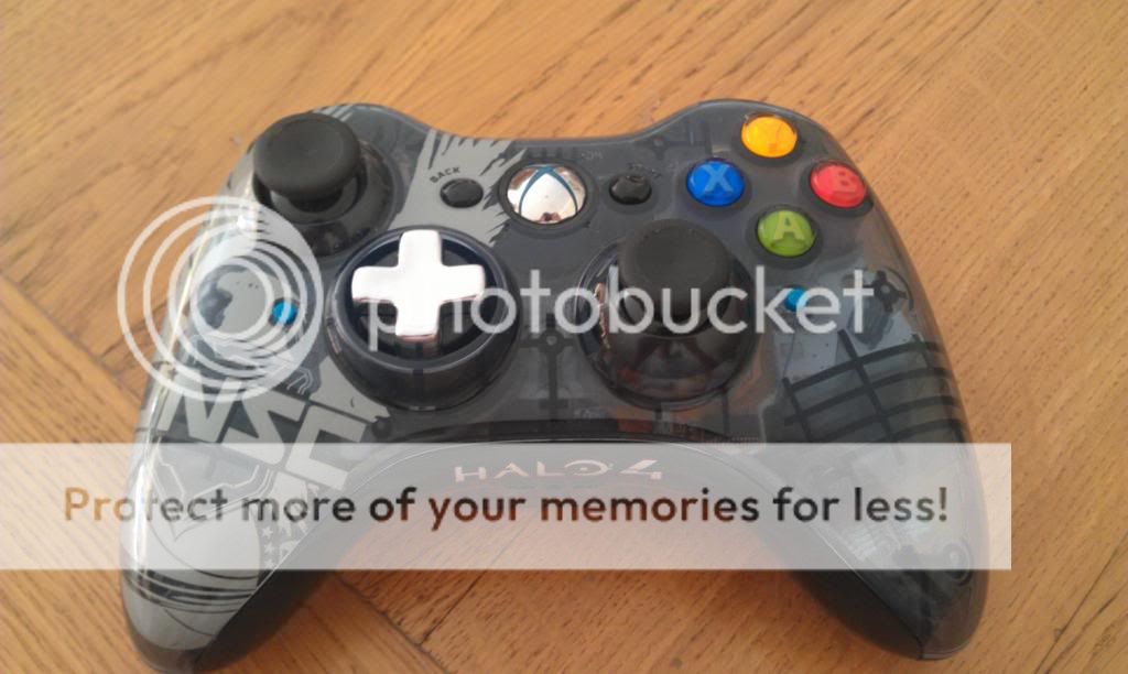

« Reply #159 on: February 04, 2013, 02:29:15 PM »

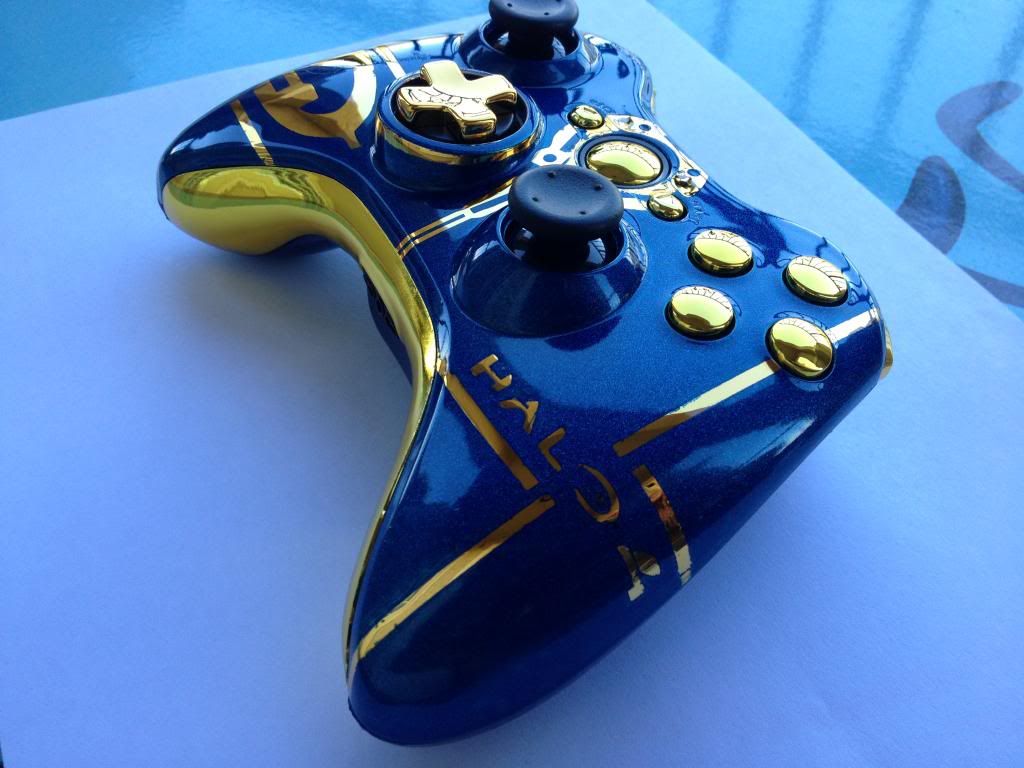

My latest Work For My Son Since He Love halo 4 So Much, he just Hit SR50
How to Teach 4 year Old Tips On Halo 4
let me know what you guys Think of the Controller

« Reply #160 on: February 04, 2013, 02:37:22 PM »
asldkfja;slkdjlaSKdfla;skdalskd;laksd
i want it
so bad
how
did you paint that yourself?
it's epic.

« Reply #161 on: February 04, 2013, 02:38:18 PM »
Great work mighty king. Chrome paints can be so hard to get right. Beautiful.

« Reply #162 on: February 04, 2013, 02:38:52 PM »
Like i said before Awesome Dad and bad ass controller there nice work as always!!

I'm guessing you painted over a stock chrome controller with a very detailed and intricate masking job.
I am so going to do this on my next controller.
I love seeing new ideas.

if that is your plan Hazer they make a automotive tape that is fine line so you will not get a big tape line where the edge of it will be masked off, IF i remember right its about $15 bucks a roll.

Yes that Is correct start it out as a Gold Shell and than Using the Cameo Cutter Did the Design than Cut it on Peal Paper, stick and than Primer
paint , Peal the paper and Clear Coat
Note: Do have to mess and play with the Cutting Software or it will cut out Everyhting and don;t look right
also when you cut make sure leave a bit Extra like Tabs so when the tape is cover by Primer and Paint you know where it is to Peal

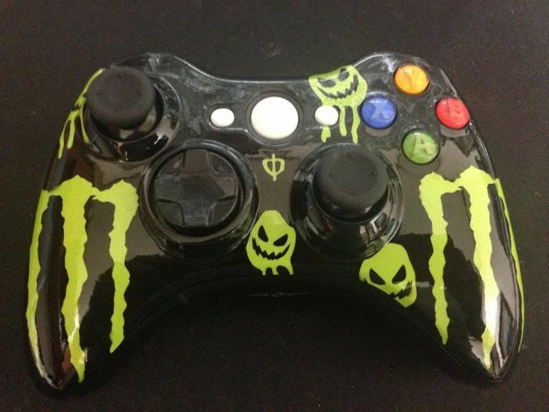

Godfather Xbox 360
Let me know what you guys think

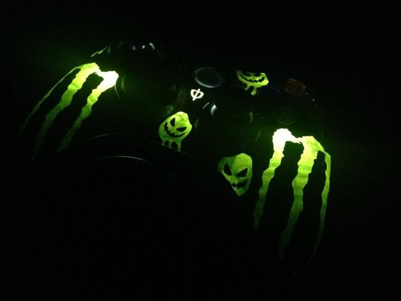

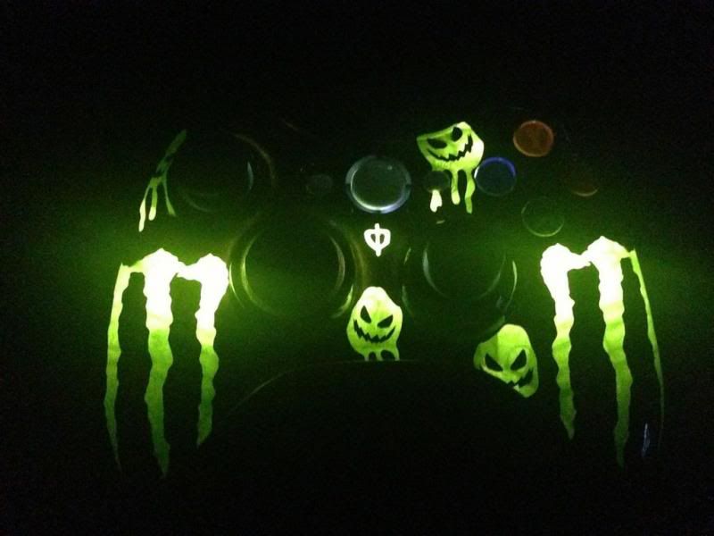

« Reply #174 on: June 13, 2013, 07:19:00 PM »
Monster illuminating Xbox 360
« Last Edit: June 13, 2013, 07:23:39 PM by KingMike_OS »

« Reply #175 on: June 13, 2013, 07:31:40 PM »
That is pretty sick!! I want to do a NOS one. Not much a fan of Monster.

I get on it right away I post it once im done

« Reply #177 on: June 13, 2013, 08:26:38 PM »
WTF!!!! I should have kept my mouth shut lol.
I want to see asap.

how mike just how you deffinitly need to share this one.

« Reply #179 on: June 14, 2013, 10:37:05 AM »
I think he explained it a few posts up. Something about making the design and printing/cutting it on one of his fancy machines. Check it out. It is up like 3 posts.
