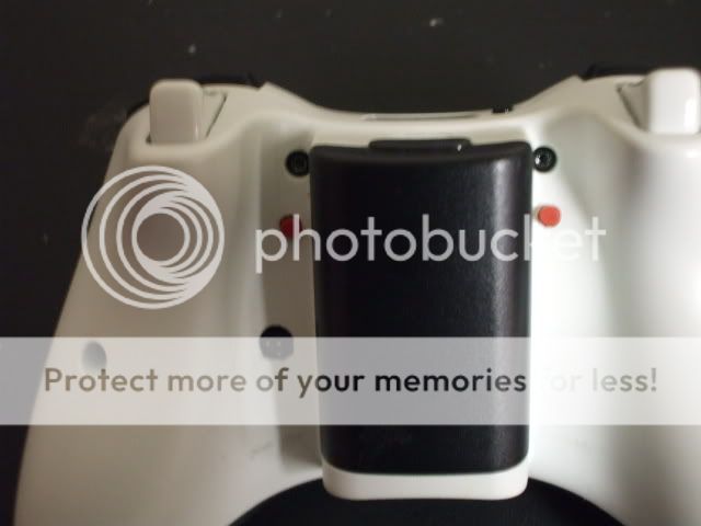

Just double rapid fire triggers. :tup: Two Resistors, wire, momentary switchs. soldered to middle pins and to ground i think?  :confused: cant remember. It  :censored: works a treat on COD 4, but WAW it's  :censored: s :censored:t! Oh well.

My first controller mod.
Switched out the LB RB, start, back, d-pad, analog sticks, battery pack, and bottom to black.
Installed COD5 Rapid Fire Dual 4-Mode Trigger Kit, used different buttons though.
Will soon be swapping the LED's to blue.

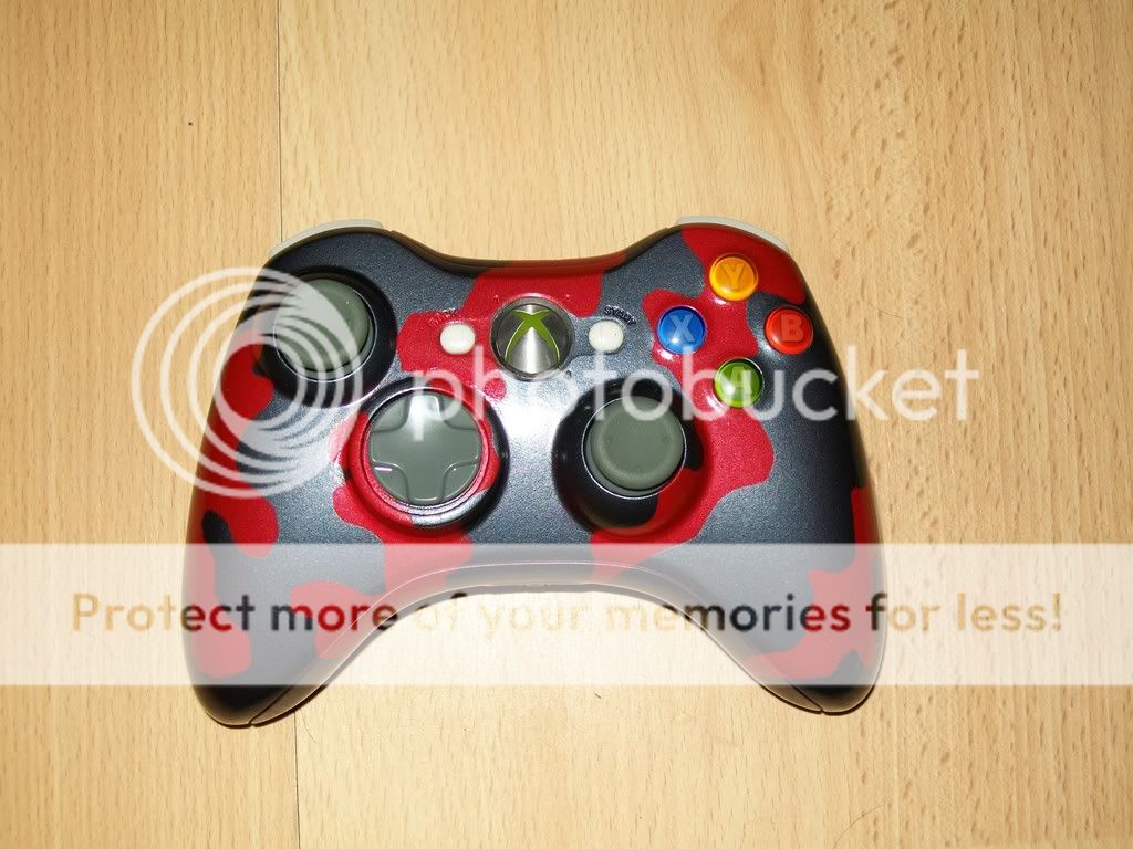

here is the new controller I did for my wife this past week.
mod list:
orange led swap
painted shell hot pink w/ black accents
4 mode rapid fire (burnme up)
shell pics:
LED pics:

Nice. I was wondering how the paint job is since I've been using Duplicolor and it's been perfect, but it only comes in a few colors. What brand did you use?
Re: Official "Show off your Rapid Fire/Modded Controller"
« Reply #45 on: May 28, 2009, 04:59:13 AM »
I will check the brand when I get home.it was expensive paint for plastics. not exactly sure, she bought it. LOL
the bigest thing with paint as I am sure you know is prepwork. the controller needs to be smooth, but not slick. I use a scuff pad from any paint store, 3000 grit steel wool works nice also. this will take that slick feel and shine off the controller without any scratches, then clean it all with a degreaser (rubbing alcohol works too), careful not to touch the surface to be painted with your hands, because your skin has oils on it you cant see that can affect the paint.
ghost, I am sure u know all of the above info, it was ment for newer members LOL
those orange leds are cool, the pic dosnt do it any justice. I wish I would have ordered more of them.
