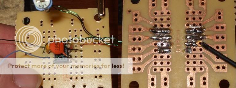

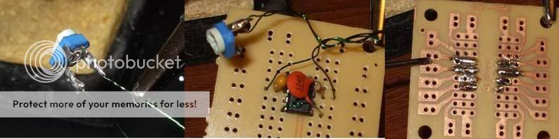

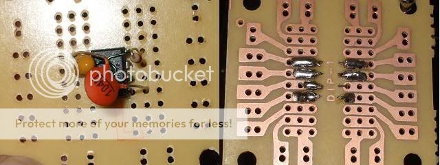

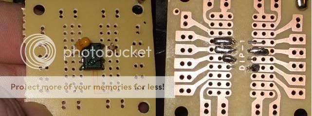

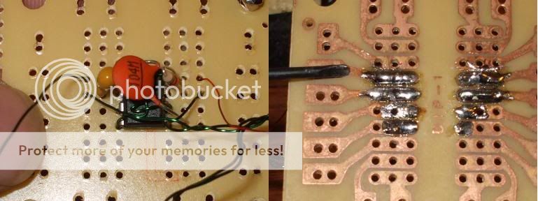

***please give king mike credit for these origional pic's I just modified them to fit my needs. thanks mike.
we want to keep all components as close to the 555 as we can.
1) Insert 555 timer into center of pc board, bend legs toward center, don’t solder yet.
2) Make two jumpers 1" long. (Two pieces of wire stripped on each end) keep it all close
To chip, put these jumpers into same holes as the chip's legs.
   2A) first jumper pin four to eight
   2B) second jumper pin two to six
   2C) solder jumpers and chip to pc board, only fill the holes we are using!!
3) Solder in 1k res pins seven and eight, make sure you have one more open hole at in eight
4) Put in 1.0 uf tantalum capacitor at pins one and two, this cap has a positive side and negative side the positive side should be in hole two. Now solder only pin two. (Leave neg side for now)
5) Put in 0.1 uf capacitor at pins one and five. At pin one, put this cap in the same hole as the last capacitor. You should still have one hole open at pin one. solder pins one and five.
6) on the pot you should have three legs, two close, and one by itself. snip off one of the two that are close to each other.
   6A) solder a three inch pic of wire to each of the remaining pins of the pot
   6B) solder one of these wires to pin two of the 555
   6C) solder the other wire to pin seven of the 555
7) solder in a long wire (6 inches or so) into the last hole of pin one (this is for gnd)
8) solder in a long wire (6 inches or so) into the last hole of pin eight (this is for vdd)
9) solder in a long wire (6 inches or so) into the last hole of pin three (this is for output)

Okay so I made my own circuit for this awesome mod and it's all done. It looks like garabage because i resoldered the whole circuit because I had a mistake I couldn't locate. Here it is:
http://imodmuch.googlepages.com/IMG_0632.JPG
http://imodmuch.googlepages.com/IMG_0633.JPG
http://imodmuch.googlepages.com/IMG_0636.JPG
http://imodmuch.googlepages.com/IMG_0637.JPG
I had to click the axel on the motor and puck back the weight to cram the board in. Again, it's not pretty, but it's functional. And i hop to never open this controller again.
Note: I used a momentary switch instead of an on/off switch. I did this trying to make a rapid fire button, but as it turns out, i have to hold the switch down an pull the trigger to activate rapid fire. Witches on Left4Dead are a breeze to kill now!
« Last Edit: January 05, 2009, 03:03:24 PM by K313k »
K313k,
as I stated in a pm this mod is for rapid fire on the trigger. to make rapid fire on a button, take the wire from pin #3 run it to your button, then to the center trigger pin and thats it. push button for rapid fire, push trigger for normal fire. this will eliminate the switch and the transistor.
I designed this to be more natural. with it on a button, it is just akward for me, but to each thier own
