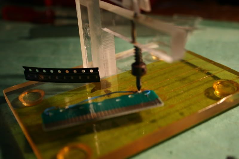

Dude... I have a tool built for it, I can show you pics if you want
Basically, its a small stand thing, with a needle, which holds the LED down, then that just leaves you to tin either sides, the just touch them both, and then hit them up for about half a second, perfect solder joint
Also, make sure you got thin solder (My solder is around the 40AWG mark, its like hair lol)
May I add, try to use the 0.125 wattage LED's, since they are tiny, like just a drip of resin (or whatever resistors are made from)

« Reply #13 on: December 29, 2008, 08:14:00 AM »
can i have a pic of you tool plz and a place to get it? phenomenaldesings
Sure
Unfortunatly they stoped making them now, and shortly after they stoped making them, they company went bankcrupt, also they are hand made
They look fairly simple to build, just go to your school technology dept and ask if you can build it (if you still go school, also most schools will let you do it free and give you the plexiglass/acrylic)
Here it is, i was installing leds onto the DS dust cover, usually i have the LED just there, but this tool is actually built for doing this (soldering PCBs, but you can use it for the single 0603 led) also the thing next to it is a pack of 0603 leds to compare its size
And here it is zoomed out in focus (the standard Canon 400D Lens hasnt got good macro modes)
That yellow stuff I added myself, as i solder LEDs directly on it, so flux gets left behind and also the fact that the acrylic melts from the soldering iron. The yellow stuff is high temperature tape from deal extreme (up to 300 C), now every once in a while, i just take it off and apply a new one, since the flux hardens over time and makes it hard to position the leds, also i just use some precision tweezers to play them correctly (When i need extra light, this makes it easy to solder 2 0603 leds DIRECTLY together in parrell (so they are back to back) which is pretty much impossible without this
