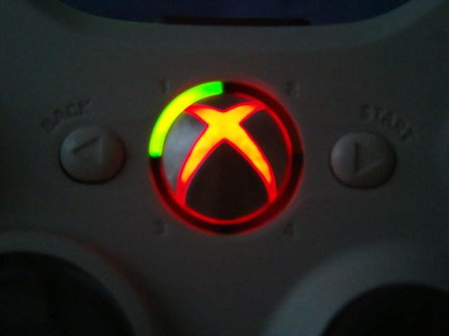

i bought 2 Rectangular High-Brightness Red LED Lamp from radioshack part number 276-008. they look good but i want them to be blinding bright. anyone know what i can do to make them brighter?? i put a 97 ohm resistor on it. thats what some one told me to do. any ideas??

thank you both. i have found it. i put a 20 ohm on it and it looks great. at first it had a 47 not a 97. put still looks better. thanks

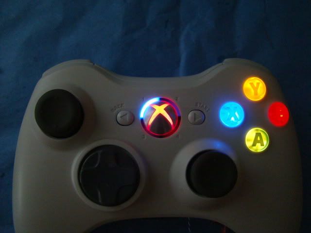

if you like it to look Brighter you can use this : you have to clean the dome and take out the center + and its a perfect replacment
Dome LED Part # link Radio Shack Part # 276-0086

10mm led still looks best in the dome, wish radioshack had more colors of it.
when i used multiple leds i had bright spots and dim spots, but the 10mm looks great.
