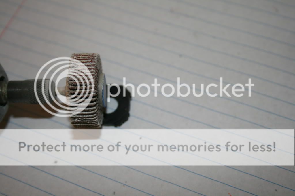

Straight away we are going to get down to dremeling the razor PCB(dont do this if using a
Razor-X)
Make sure you get it super thin, cause it will be a struggle to get the assembly to fit

Now we are going to sand down the top part of the analog. Try to get it really thin, but
make sure you dont go through the plastic.(skip if you gotta razor-X)

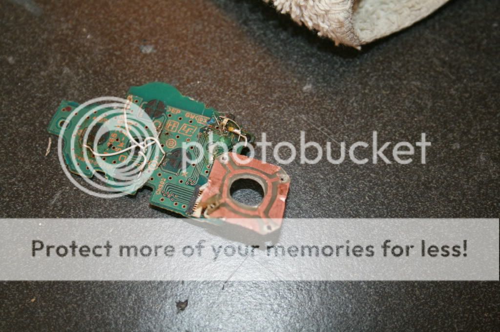

Ok, now here are the traces for all the buttons on a psp phat. If you are using a
slim, the traces will be different.
Solder on a wire about 1 inch long to each of the traces, and make sure you know
which one is which.

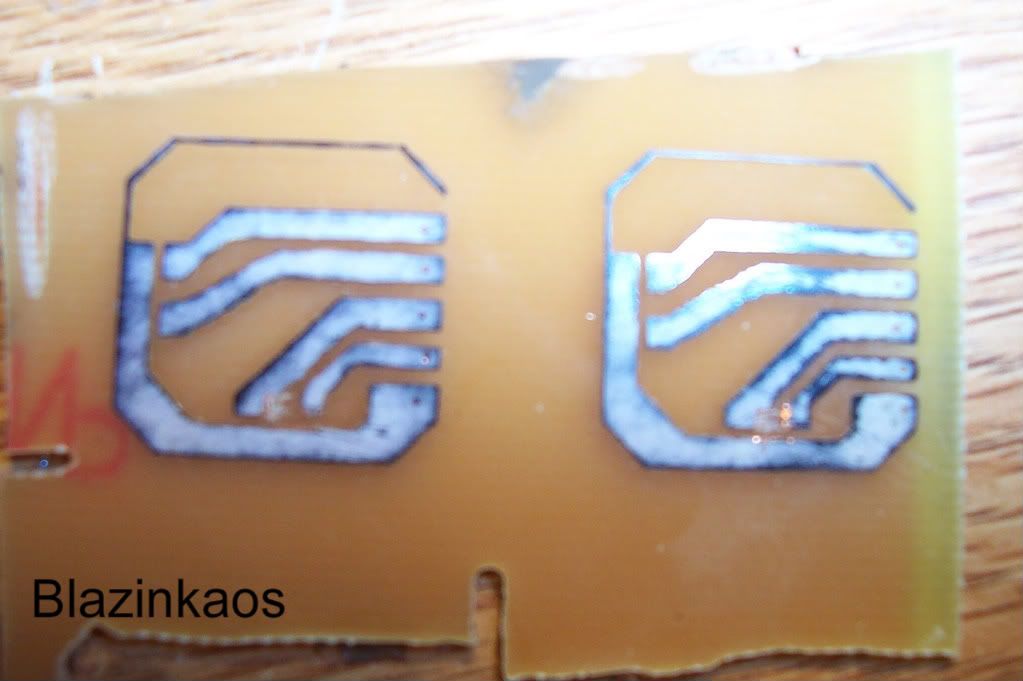

Now, lets get the Razor ready for soldering.
I use a stone-wheel dremel head to dremel just until i get to the copper, making
sure not to go too far.(Urggg... again, if you got a razor X, skip this.)

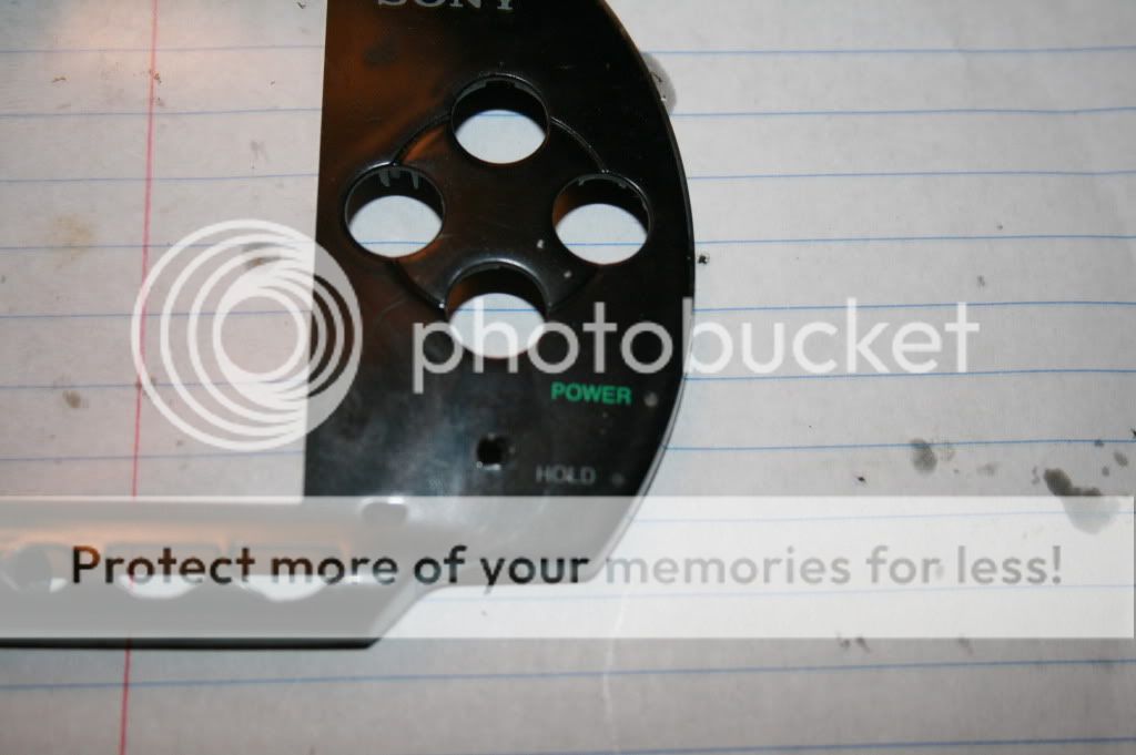

Also, in the picture above, you will notice i dremeled out all the bumps and deformations
on the psp faceplate. I dont have a picture of were to dremel these things off, so im
going to use a french guys pictures.
As you can see, you will have to dremel a bit off of the faceplate to make it work.
I use a variety of dremel heads to get the job done.
I start with the smallest little drilling one, and move on to the other ones to get it the
right size.

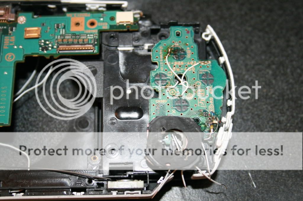

Done with making the hole, now just need to mount the whole assembly.
I mount it right where the corner is at the corner of the ZIF connector where the ribbon
cable for the HOME buttons goes in. I put a little bit of hot glue around it to hold it in
place.
Now, just put the psp back together and your done!!

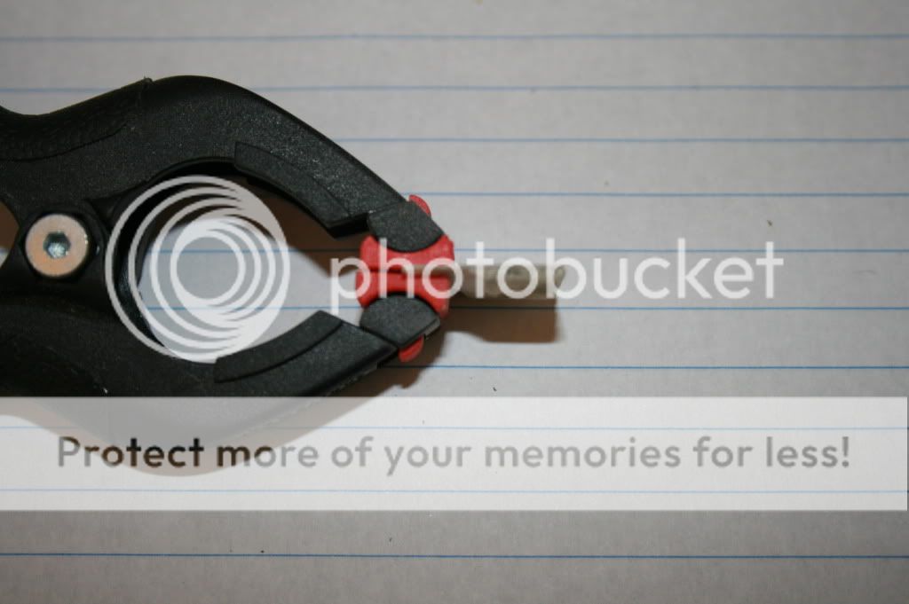

I am using clamps to hold it together, cause im using a special glue to hold it together.
(I dont have it on yet, as im not done modding this psp yet. I still have a few mods to
do on it, fill you in when im done.)
There is what the thickness will hopefully be like if all the glue holds it good enough.

The Razor X is a special board put on a regular analog module so that it can be used for the dual nub functions, like this:
