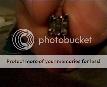

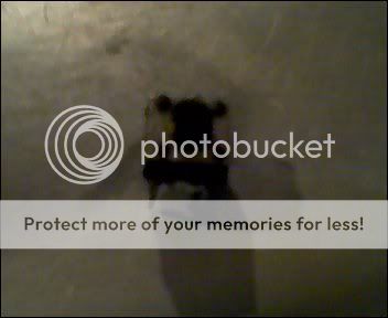

hey, ive got a 4 prong button i think its the same as the one's on the AM shop...
i was wundering how i could wire it up to some leds the to the psp, so when i pressed it the leds would come on.... just like the hold switch method but so i can still play.

I think you have a dpst switch. To wire it, I'm not sure how to figure out which poles are connected, but basically you wire one pole to positive of led, one to positive point on mobo, one to ground, and one to negative on led. Not sure if you really have a dpst switch though, can't really see your pics very well.

lol k no problem. I'd like a good picture of the bottom of the switch though please.

best quality i can get lol mum cam is broke im using webcam...

Thanks those will do fine. I have no clue how to tell which poles are connected but do you have a multimeter? If so, then
1. turn the switch on/close the switch
2. turn your multimeter to continuity/diode testing
3. put the two prongs of your multimeter on any two poles
4. if it tells you there is continuity, then good, you know that those two poles are connected. Write it down and tell me. If not:
5. keep on prong on the same pole and move the other prong. If you have continuity now, then write it down. If not, you know that the last pole and the first pole have continuity.
I just need to know which poles are together so I can tell you how to wire it.

Sorry bustinthejustin, but I can't help but feel you have no idea what you are talking about  :laughing:
You have a tactile switch.
The poles are connected lengthways IE. the two contacts on the same side (on the top in your 3rd picture) are NOT connected.
A tactile switch is momentary (unless it is the latching kind - yours isn't), so you cannot simply wire leds to it and operate it like the hold switch - they would be on for as long as you hold the switch down.
You will have to use a PIC to make the switch latch between closed and open (not mechanically, via software) (in other words a bistable multivibrator).

No No Justin is all wrong you just solder the - or + to one side of the tact switch and the + or - of the mobo to the other side so when you look test for continuity make sure it doesen't beep when the buttons is not pressed it has to beep when the buttons is pressed if not you will be soldering to the same set of legs and it wouldent work if you planing to just use a tact switch to controle your leds so that when you press it the leds come on and when you press it again they shut off the leds will only come on when you press the button and hold it as soon as you let go it cuts the curent shutting your leds the only way it would work is using a pic you could reffer to alien with pic hes a beast.

If that is the case, then simply wire it as if it were a normal switch through the two legs on any one side.

Oops sorry didn't realise you had a tact switch... Damn. Sorry... But if gamerdude wants them the way he wants them, I'm technically still right. I haven't posted any wrong information except for the fact that I said to "close your switch" which would require him to hold it down, and the fact that I thought he had a dpst switch. Anyway, yeah Alien says that the two contacts on the left and the two contacts on the right in your third switch are connected. So use one set for + to led and to mobo, and another set for ground and - to led.
