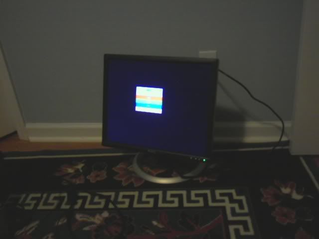

I went to my local recycling center to throw away cardboard and i found a 19" Dell 1905FP monitor there. I took it home and checked it out but it didnt power on. I then took it apart and took out the power board:
2 capacitors were popped
I put in 2 new capacitors that i got from other power boards that i had.
It works!
I hope this helps anybody who has a broken monitor
