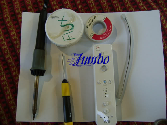

Parts Needed
--WiiMote
--4x SMD 0603 LED
Tools Needed
-- 15-30 watt Soldering Iron
-- Solder
-- Triwing Screwdriver
-- Flux
Picture of things needed
Average Time To Complete- About 10 Minutes
Difficulty Rating-1/5
