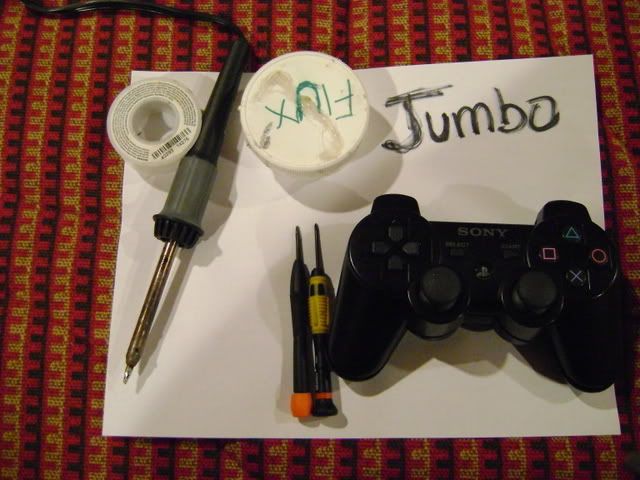

Parts Needed
--PS3 Controller
--4x SMD 0603 LED
Tools Needed
-- 15-30 watt Soldering Iron
-- Solder
-- Philips Screwdriver (I used #00)
--Flat head
-- Flux
Picture of things needed
Average Time To Complete- About 30 Minutes

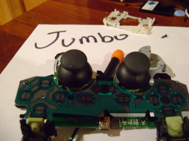

Now take the battery out of its bracket and disconnect the plug.
Then take out the mobo screw(1) and vibrator screws (4)
Now that that's over with, Take the whole thing out-
Carefully remove the membrane and analog toppers (So iron don't hit them on accident)-
LED Pinouts-
Remove the leds and solder on your new ones according to the pinout-
(Orange LED's FTW!)
