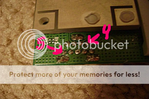

After that is all finished unscrew the RF Module from the front and then disconnect it. This is a macro shot of the pins that we will be soldering to. The arrows point to pins 4 (ground) and 5 (power enable)
My reed switch didn't have wires so I had to solder wires to it but yours most likely will so I'll skip that. Our next step is to solder the reed switch to the RF Module. Positive goes to pin 5 and ground goes to pin 4. It can work either way but I like to match them up.
